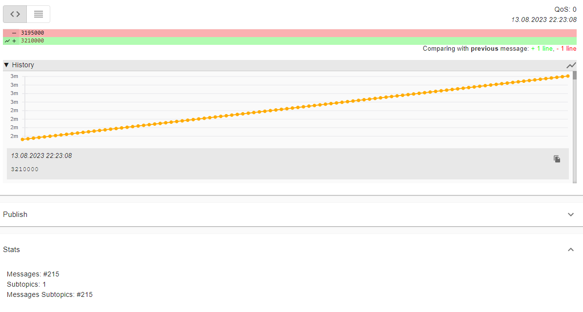

The connection appears to be stable on Wifi (have not tested wired ethernet):
My test data is posted to broker on a regular interval.
Edit:
Noticed that I in my first post were using PubSubClient library 2.8.0
Just did a quick test now and it looks ok now also.
