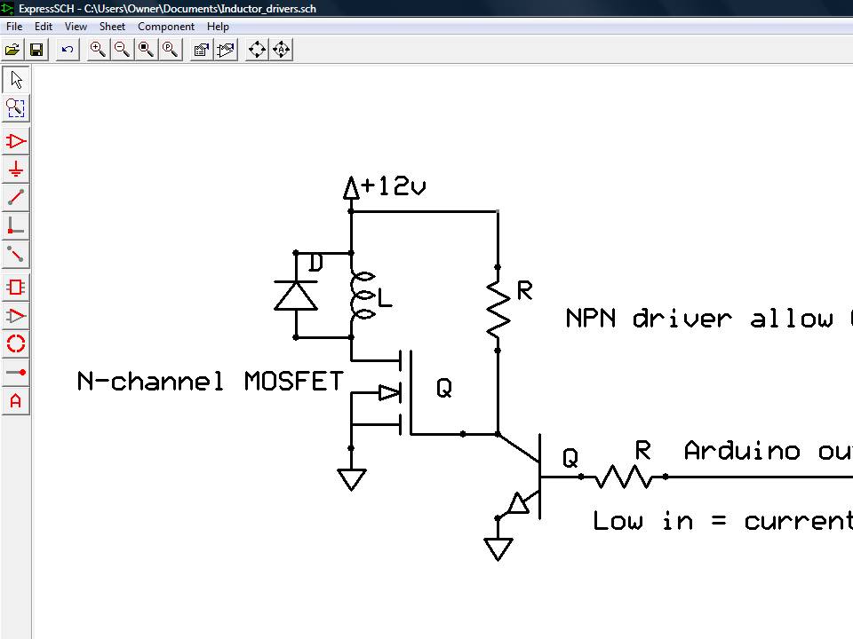

Need this to Source current into the inductor
Connect ground to arduino ground.
I always found it easier to put an N-channel 'below' the inductor to connect to ground, easier to find parts work with.

CrossRoads:
CrossRoads, other than the MOSFET being a low side switch in your schematic, isn't the circuit you have given similar to my circuit? If that is the case, I don't think it will work because emitter voltage will still only have a 0.7 V difference from the base voltage..
I was trying to arrange that so a High from arduino acted the same in both cases.
I myself would wire it like this and just invert the logic of the control line.
I myself was thinking about doing that and after your post, I've made up my mind. That's the way I'll go. Thanks for all your help.
