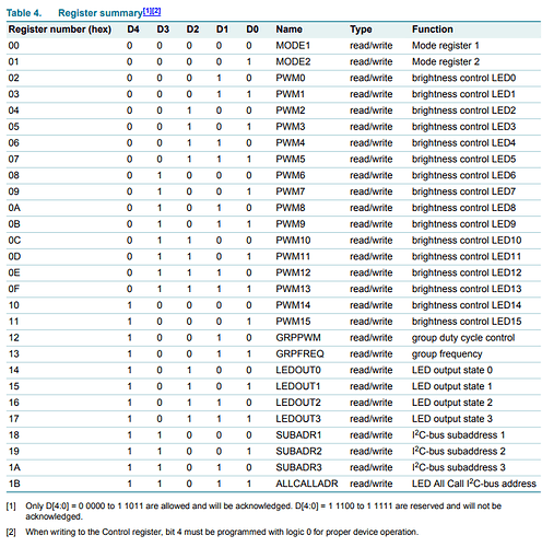

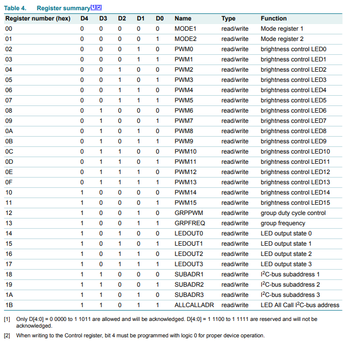

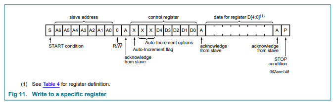

I am trying to write a library for the PCA9636 IC. It is a 16-channel PWM LED driver. I have found libraries for this chip but they are either not compiling for my board (Zero) or they plain just don't work. I am rather new to programming I2C and using the Wire library, so I am quite stuck.
As far as I can tell, I can successfully write to a register. At the same time I am trying to verify this by reading from a register that I just wrote to but this is where I am stuck. My code so far:

All I am getting on the serial monitor is 0s. I attached relevant datasheet info, sorry I don't know how to embed it in the post...
Can someone please tell me what I am doing wrong? Thanks for any help!
why do say that? can you control the chip?

Okay, partial success!! If I use the all-call address 0x70 instead of the hardware wired (and I2C scanner confirmed) address 0x28 it actually works. Confusing but better!
Okay, so I have the chip going by now by simply setting a different address. Some confusion went on.
First of all, my thought-to-be address of 0x28 didn't actually represent the hardware wired I2C address for the chip. My wired address was 0x00 which seems to be a sort of catch-all I2C address. That's why that partially worked. But took me a while to realize.
At the same time, I also discovered this: When I remove ALL I2C devices from my bus - literally just "empty" wires on my breadboard then - I2C scanner still shows me 0x28 address to be available and responding. I don't really understand why but for my system here, it's a fact.
So, after discovering all of this, I could make it work. If anybody has any clue as to why I am seeing this address on my bus, please let me know :slight_smile:

Wired address : The PCA9635 has 7 pins to be configured high or low as the I2C address. That's what I meant. Out of laziness I set them all to 0s to start with. That would have made it 0x00 but that address was never shown to me, maybe because it is "reserved" or so...?
PCA9635-1127577.pdf (173 KB)
did i read the datasheet correctly, that there are 7 hardware address pin? if so, doesn't this mean they fully specify the address.
