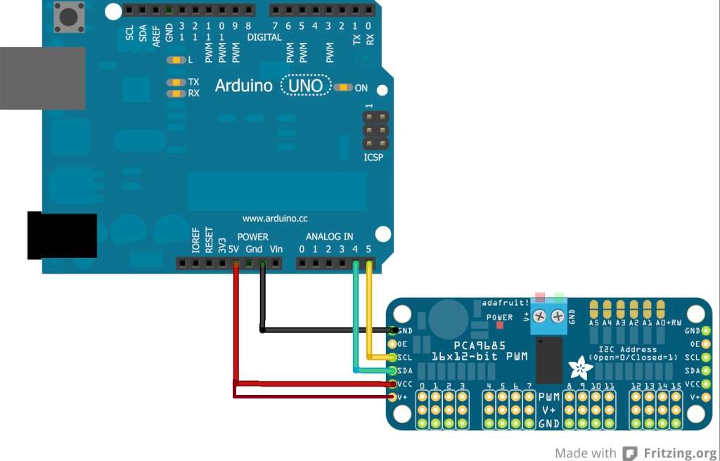

Hi, recently I bought 2 PCA9685 controllers to control servos, but after running I2C test I got addresses: 0x03 and 0x70, and PWM doesn't work. I tried running it on Uno and 2 different Nanos, but the result it still is the same. The schematic is the same as in the picture. Is there something wrong with the circuit, or are those 2 bards faulty?

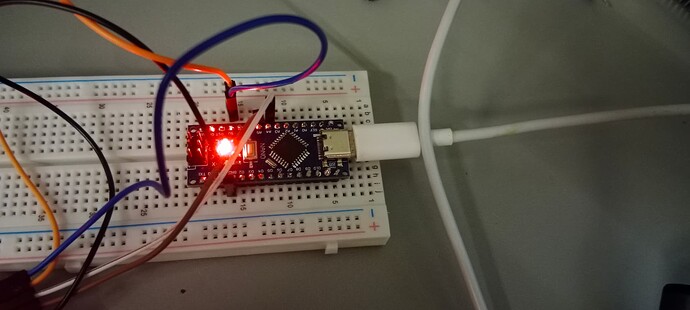

Could you please show a photograph of your setup that shows clearly how everything is connected?
There is Nano connected now, but I tried on Uno too.
Looks reasonable; have you tried adding pullups to SCL and SDA? I'd suggest 4k7 or so.
The device responding at 0x70 is the PCA9685 too. Taken from the Adafruit PCA9685 board FAQ:
The PCA9865 chip has an "All Call" address of 0x70. This is in addition to the configured address.
Just tried after adding 5k, still same result.

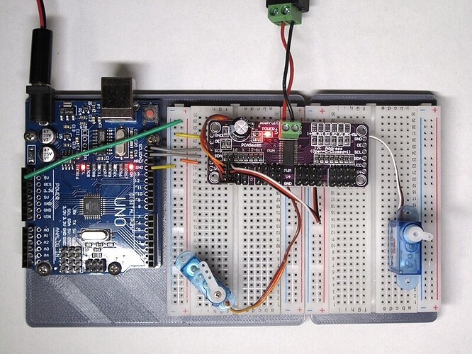

As a data point, i dug out and wired up a 16 channel PWM clone board, a couple of servos and a 5V supply with an Uno.
The I2C scanner sketch picked up the PCA9685 at addresses 0x40 and 0x70.
Next, I compiled and uploaded a simple servo sweep example. The Adafruit_PWMServoDriver instance was declared without an address passed to the constructor, so it got the default of 0x40. When power was applied to the PWM board, the servos moved.
No problems, no gotchas, no "oh you have to remember to do this"... just slapped everything together and it worked.
Oh, and the PWM board should have 10K pullups already on SDA and SCL. I checked and my clone board has them, so yours likely does too.

Try disconnecting the blue wire that goes from the Nano to V+ on the module board
I see several "cold" solder joints on the Nano.
Try to leave the soldering iron a few seconds longer on there, so the solder has time to flow.
Remove that blue wire (don't connect anything to V+ of the PCA).
Servos should receive power from the screw terminal, not from the Nano.
