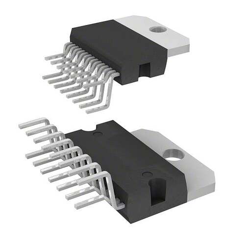

L298N is a good H bridge for driving motors, or you can get an Arduino shield for motors that simply stacks on the R4.

A chip that has been obsolete since before the start of this century?
The big problem with it is that it has too much voltage drop, So even to drive a 5V motor it will require at least an 8V power supply.

Yeah it's obsolete but it works.
I still use CD4000 series chips for some things :joy:
I laugh because I hang onto things that I know that 'just work'. I actually like being able to do more with less when possible
Obsolete yet sold everywhere, cheap and easy to get. Digikey has 10k in stock. And it accepts a wide range of voltages :person_shrugging: what's not to like there. (Except it doesn't have mosfets and it gets hot)
