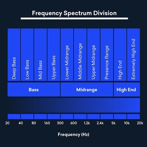

Now, i want to sync brightness of LEDs with the songs that i am playing. A song has audible frequency range of 20Hz to 20KHz which i want to spread across 126 LEDs. First LEDs should response low frequency range; and as we move towards last LEDs, they should response high frequency range. So that will be like, when a song is playing a bass-drum/kick, first LEDs should glow brighter than rest LEDs of the strip; and when only singer is singing and bass-drum is not playing, then only mid LEDs should glow brighter. I hope you get a clear idea of what i am saying here.
If you still not, then please check the video linked below, which exactly explains what i wanted to say above. In this video, you can hear and see voice of the vocalist between 00:46 to 00:54, bass and snares between 00:55 to 01:04 and high-hats between 01:05 to 01:06....
And below are some more example which explains the same...
Please help me finish this project. Thank you :slight_smile:

What you're trying to build is called a spectrum analyzer. Or actually, a spectrum analyzer effect. A real spectrum analyzer is an expensive piece of lab/test equipment. :wink:
...I have not built one, but I know a lot about audio and I have made sound-activated lighting effects.
There are FFT (or FHT) libraries that will give you the amplitude of multiple frequency bands. (In this context the frequency-bands are called "bins".) Then you can do whatever you want with that data.
There are some trade-offs and it might not be practical to get 126 frequency-bands/bins (if that's what you want).
Usually bins are combined (at least at the higher frequencies because the bins are "linear" but we perceive frequency & pitch logarithmically/proportionally. i.e. We might have a frequency-band from 50-100Hz (one octave) but we probably don't need a band from 10050 to 10100Hz (a fraction of an octave). Of course, we also perceive loudness logarithmically/proportionally and decibels are logarithmic.
If you can live with only 7 frequency bands, there is a chip called the MSGEQ7 that takes a line-level signal and gives you 7 (multiplexed) outputs with a different-varying DC voltage for each band. That makes the software a whole lot easier since the processor can focus on running the display. (Addressable displays and FFT/FHT are both processor-intensive.)
How are you going to "read" the sound? You can use a microphone board or you can make direct connection to a line-level signal, but a direct audio signal has to be biased because the ADC can't read the negative-half of the waveform. Without the negative-half you'll have bad distortion which will totally foul-up your frequency display. And, the Arduino can be damaged by negative voltages.
A microphone by-itself won't work. A microphone board made for the Arduino will have a built-in preamp and biased output.

Unfortunately, i don’t want to assign brightness of LED to volume of a song/music. (I hope you already know that, volume is measured in db, while frequency is measured in Hz.) Instead i want frequency (20Hz to 20,000Hz) to manipulate brightness of LED strip.
For example, i have strip of 126 LEDs. So i want to assign brightness of first 42 LEDs with bass frequency range (20Hz to 300Hz), next 42 LEDs with mid frequency range (300Hz to 5000Hz), and last 42 LEDs with high frequency range (5000Hz to 20000Hz).

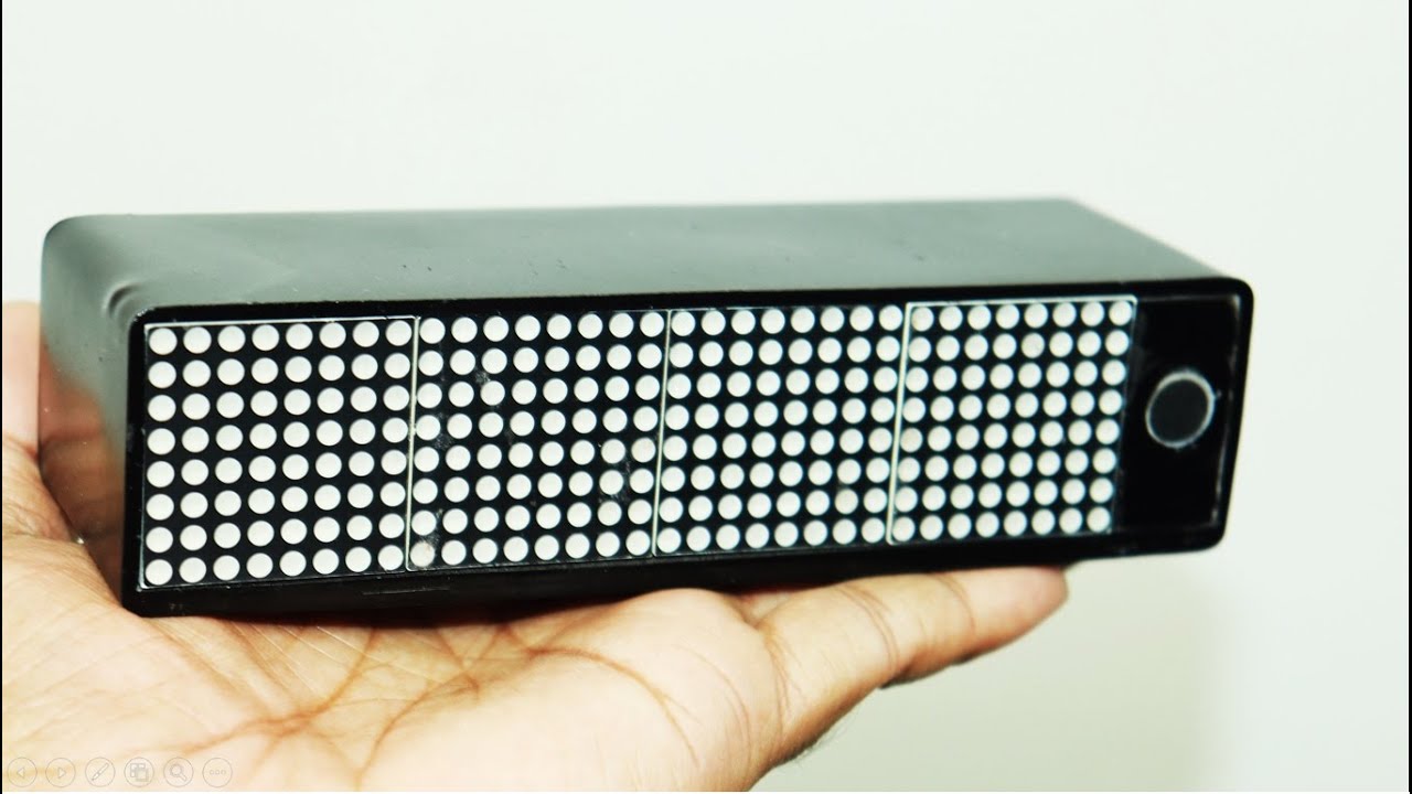

I have searched on youtube but i had never find the one which i was looking for. Please share me a video link of what i explained and required in my very first post, i will be very thankful. And i am quite sure that, this is going to be the future and most teenagers will own something similar in their homes when they play their fav songs.
Here is how I synced a LED strip to music using a MSGEq7 and a Adafruit Electret Microphone Amplifier - MAX9814 with Auto Gain Control [ADA1713]. Using a ESP32.

Yeah, it’s like the one in the video below, am i right?
But i am not interested in creating something like that. Instead i want different frequencies to manipulate brightness level of a single LED strip containing 126 LEDs. Is it possible with MSGEQ7? If yes, then can you please show me a circuit diagram?

Does this mean a chart/graph like this?
Thank you very much A7.
I meant, in my references to the bar graph, the LED bar graph spectrum analyser / display devices that many ppl build and show off on the internets.
This is the kind of software you need to understand and adapt for your purpose.
Read all the advice here: you have been variously directed to most of the ways this can be done. The determination of the amount of sound energy in a given band of frequencies.
In those bar graph spectrum LED displays, those numbers are informing how many LEDs in a given column (frequency band) are to be illuminated.
This is where, instead, you decide how bright to make the one LED representing that coulumn, that is to say, that frequency band.
