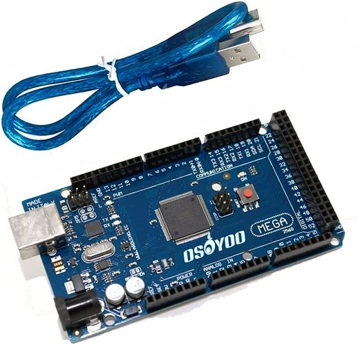

please help wit coop door
Please for the love of all things holy someone help me with this code. I have been working on this for 2 weeks and have tried using two other people's code and can get no luck so I tried writing my own with trying to follow their guidelines. I am very very new to this and apparently not so good. I am building an automatic chicken coop door that works off of a photocell. I am using an Arduino Mega 2560 with a L298N driver and a DHT11 temperature sensor because I would like to control a dc fan inside the coop as well.
I am getting the following error:
Arduino: 1.6.10 (Windows 10), Board: "Arduino/Genuino Mega or Mega 2560, ATmega2560 (Mega 2560)"
C:\Users\GERAR_~1\AppData\Local\Temp\ccuL4sTS.ltrans0.ltrans.o: In function `main':
ccuL4sTS.ltrans0.o:(.text.startup+0x5fc): undefined reference to `motordown()'
collect2.exe: error: ld returned 1 exit status
exit status 1
Error compiling for board Arduino/Genuino Mega or Mega 2560.
This report would have more information with
"Show verbose output during compilation"
option enabled in File -> Preferences.
Thanks in advance!

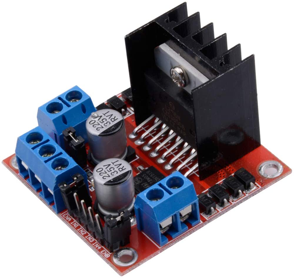

okay, I put in the code that "Spycatcher2K" put in and it allowed me to send it to the Arduino. Problem now is that it isn't working properly.
my led lights work properly but not the motor. it seems that the "while" function isn't holding because when the reed switch breaks contact the motor immediately stops instead of running until it hits the opposite one.
SwitchState1 and SwitchState2 are silly names for variables. It makes it difficult to understand what the code is doing. You've given everything else a good name.
I would change these variables to DoorIsFullyOpen and DoorIsFullyClosed. That will help making the program readable. Also, if you're new to C, you won't be used to reading the logic operators. Just remember, every time you see a !, it means "not". So...
while(! DoorIsFullyOpen) {
  //motor drive in the open direction
Now it should be much more obvious which direction the motor is going and which switch it's looking at to decide when to stop.
On top of the good comments above, with recent updates to the IDE,
  pinMode(topSwitch, INPUT);            //top reed switch set as input
  digitalWrite(topSwitch, HIGH);        //activate internal pullup resistor
  pinMode(bottomSwitch, INPUT);         //bottom reed swithc set as input
  digitalWrite(bottomSwitch, HIGH);     //activate internal pullup resistor
is now better written as
  pinMode(topSwitch, INPUT_PULLUP);            //top reed switch set as input with internal pullup resistor
  pinMode(bottomSwitch, INPUT_PULLUP);         //bottom reed swithc set as input with internal pullup resistor
I did as suggested. Now my two led lights stay on continuously and the motor only runs when the bottom switch is engaged and stops when the contact breaks. My serial print works great and I can tell when the switches are making contact and that the light and temperature sensors are working well. I still seem to be having a problem with the sequencing and having the motor work with the photocell and also to stay engaged when the door is traveling.
Again, thanks in advance for any help. I'm at my wits end with this program but NEED to get it up and running.

in1 and in2 are what is labeled on the L298N controller and as far as I could figure out and have seen before I have these set to turn on and off the motor.
Right now if I activate the bottom reed switch the motor runs regardless of the photocell reading and both LED lights stay on regardless of switch position and the motor stops when the reed switch is moved from the bottom position.
can you clarify how your motor works, what really gets it to move?

what does your L298N controller look like?
can you post a link to your version? and which Arduino pins are linked where?
It is just a normal 12V motor I have one wire on the "Out 1" and one on the "Out 2" on the control board. I have the power coming direct from a 12V source to the +12v and GND connectors. As of right now the only way to get it to move is to activate the bottom reed switch.
255 is to turn the motor on high speed. I tried to mimic two other people's codes to do the same thing and they both had that command in there.

@gerard
can you connect only this (as you have) and disconnect the rest
pin 9 to enA on controller
pin 22 to in1
pin 24 to in2
Motor on OUT2
12V in the Motor Power supply
GND to ground
Make sure you KEEP the 12V jumper and that you REMOVE the ENA jumper
and load this program and run it and report on what you see
