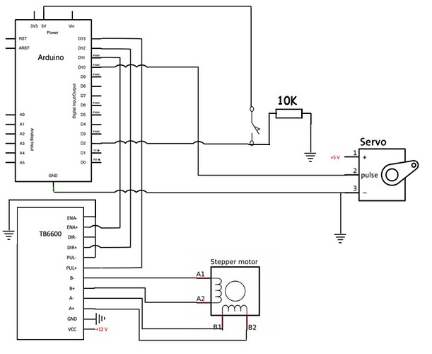

Please modify the code , stepper motor rotate one direction please modify the code ,when pin 4 ON then stepper motor rotate backward direction

Your schematic shows ENA-, DIR- and PUL- not connected to Arduino GND.
Because we are not you, we guess

What sensor is read on pin D4? Switch? Thermometer? PIR?
[edit]
This line:
   pinMode(4, OUTPUT);
keeps Pin 4 at zero.
switch
Is that how the switch is wired on pin 4? That is wrong. The switch is floating while it is open which means that its state is indeterminate (unknown).
A better way to wire the switch is to wire one side to ground and the other to an input (pin 4) set to pinMode INPUT_PULLUP. You will have to adjust the logic in your code to reflect that the pin will read HIGH when the switch is open and LOW when the switch is closed.
slp
if the switch/D4 (I used a slide switch, because it needs to be on at 2 seconds) is allowed to go high, slp immediately is non-negative, so the introduction never occurs.
A Simulation oops... i lost my switch... fixing fixed.
i tested pin 4 to gnd using limit switch , but stepper rote one direction ,
HI,
Note the added resistor, 10K, and the gnd to the ENA-, DIR- and PUL- .
Your code changes the direction of the pin (dirPin HIGH) but then immediately changes the direction again (dirPin LOW)... and because this (backward and forward) is in void loop() the stepper just stands still.

Should the dirPin be changed in any way?
(note: Pin 4 is not read in void loop())
Hello, @TomGeorge - I think the button/switch is going to pin 4... the following was...
  pinMode(4, OUTPUT);
In the simulation, the line is now...
  pinMode(4, INPUT);
@somasekharjamalla - I also noticed your were trying to print the captured serial input, but you were telling the Arduino to read one more time, which left the "capture" output empty.

I also think your stepper motor will not work "backwards" because your f_stepper() function is multiplying numbers that are probably zero (0*?=0).
I updated the simulation to show events as they happen.
Thanks sir , my problem fixed
