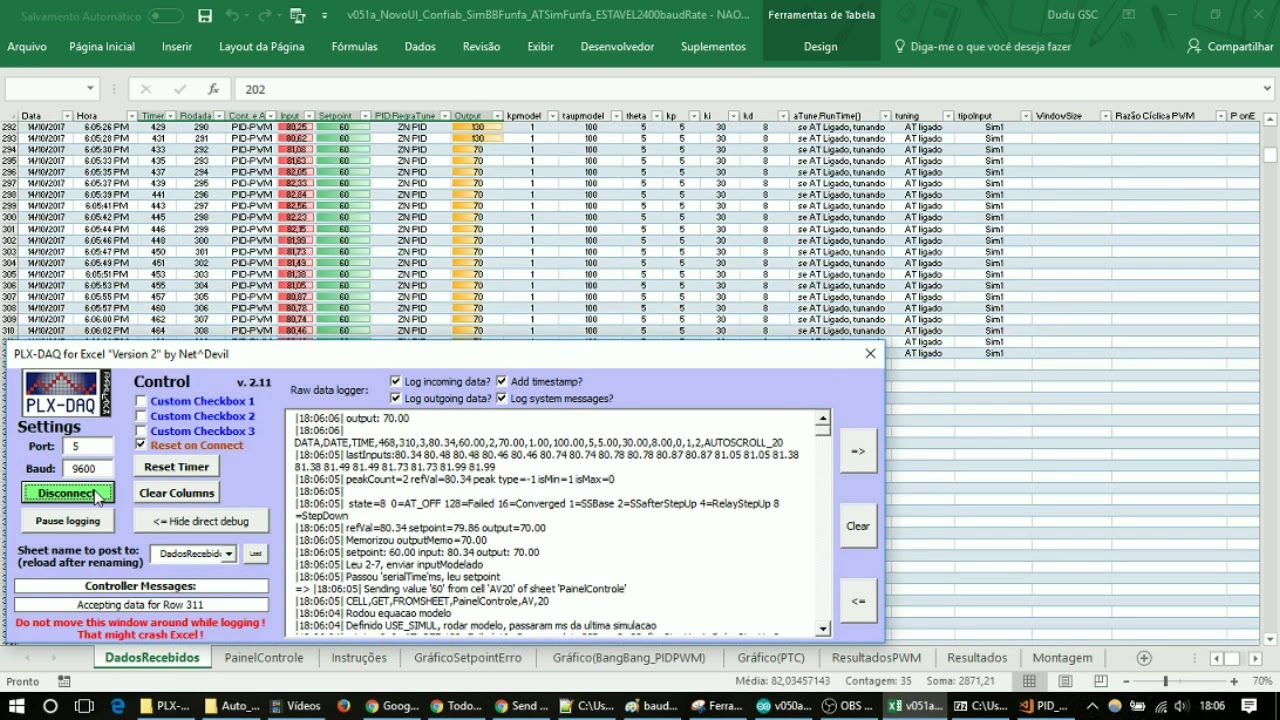

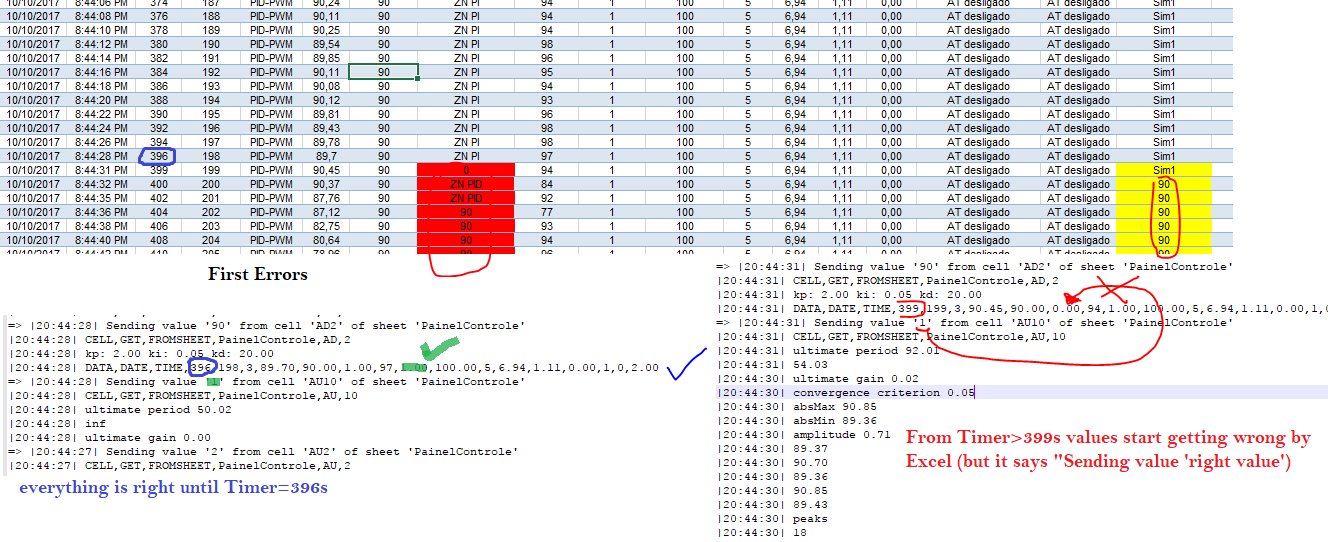

Is there an instability for running for too long?
After some time, some values start getting a little crazy (even though they seen okay on Direct Debug Window).
Is it because there're many cells being sent/written?
Should I lower the baudRate? Increase buffer?

Robin2:
Have a look at the examples in Serial Input Basics - simple reliable ways to receive data.
The technique in the 3rd example will be the most reliable.
...R
On another topic about the Serial Data being reliable, they cited this 3rd example. Don't know if the idea of using start-marker and end-marker is the same of PLX-DAQ code.

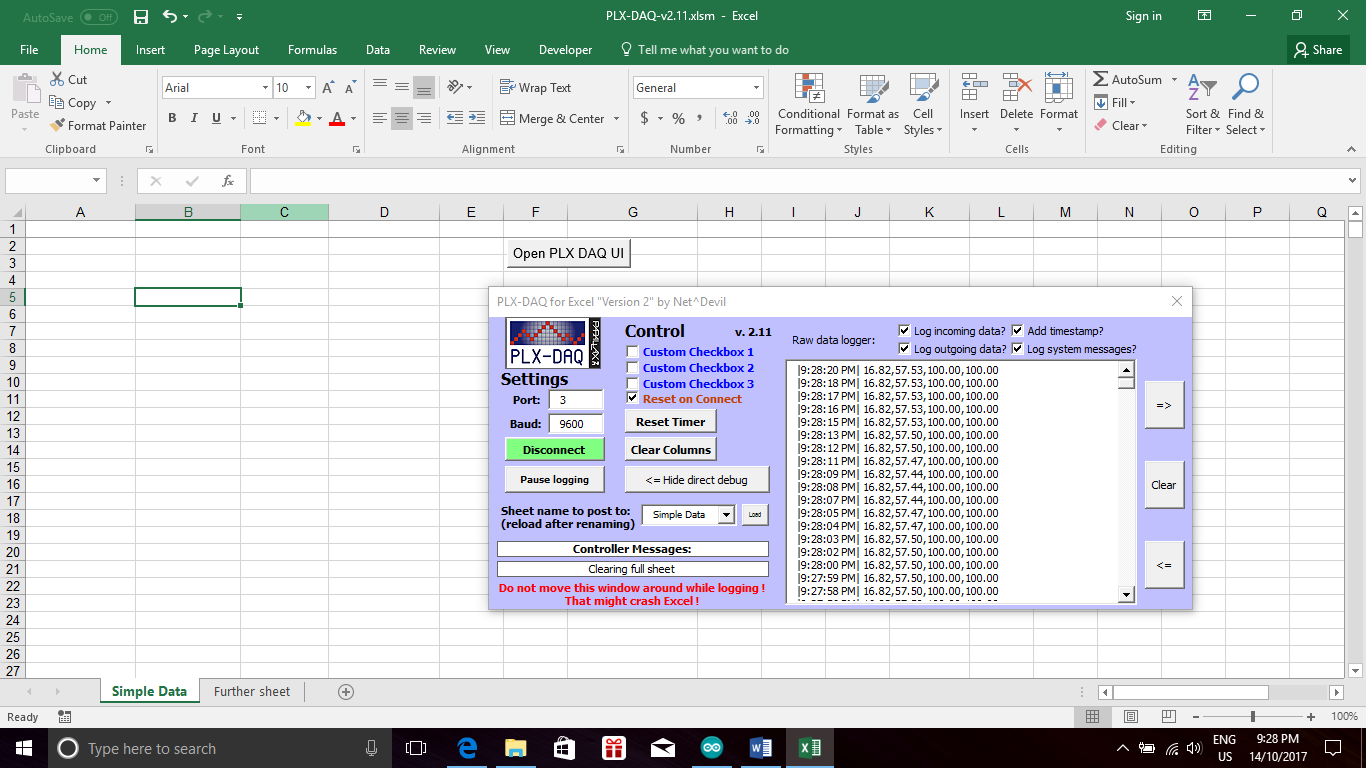

Apparently solved after setting baudRate to 2400.
Tip for others having same problem: READ the begginer's guide made by NetDevil! I discovered my switch wasn't working because I was using Serial.readStringUntil(10).toFloat() and should be using Serial.readStringUntil(10).toInt() !
Thanks!

OK I am a new with Arduino
I read the Beginners guide, look in this forum, installed Version 2.11, and everything seems fine. I can even read the Arduino data in the "Raw data logger:" but no data goes into the spreadsheet. I can even clear the existing data with the "Clear columns". Everything seems to be working exactly as it supposed to expect there is no data being written in the spreadsheet.
I am using Windows 10 and Excel 2016.
Any idea of what is going wrong and how to fix it?
Thanks

  • There actually is an issue when using a too high baud rate. Data will get mixed up pretty soon - my best guess is, that it depends on your computers speed. Nevertheless I found a general improvement of PLX DAQ v2 engine (see post for version 2.11 "Backlog for next version(s):") but haven't had the time to actually implement that. Therefore it is most suggested to run PLX DAQ on low baud rates like 9600.
  • I haven't had it running for longer times. Does it really get buggy? In case the data is received correctly in DirectDebugWindow it would imply and issue within Excel - most likely due to too many cells being used. That would be a pity but I guess hard to solve :-/

On my worksheet, with baudRate=9600, CELLGET fails (returns 0 or 2) after some time (100-400seconds after start), goes back to sending the right values, but eventually Excel crashes (can occur at 300-600 seconds after start).
I already added delay(200) before CELLGET, dind't solved, and other delay(200) before CELLSET, it keeps senging wrong values and eventually crashing (before 200s).
Thenk I tried to ""force"" reading the right values.
delay(200); //supposed to, but didn't solve the wrong values
Serial.println("CELL,GET,FROMSHEET,Control,AV,20"); //read AV20
valAD20 = Serial.readStringUntil(10).toFloat(); //(yes, valAD20 was declared as double before setup())
//verify if it was correctly read
while (setpoint == 0 || setpoint == 2) { //because 0 and 2 are wrong values that appear for me
                                          Serial.println("Wrong read, read again until get it right!");
                        delay(300); //even bigger delay
                        Serial.println("CELL,GET,FROMSHEET,PainelControle,AV,20");
                        valAD20= Serial.readStringUntil(10).toFloat();
                        Serial.println("PAUSELOGGING");
                        Serial.println("SAVEWORKBOOKAS,ReadWrongValAD20");
                        Serial.println("RESUMELOGGING");
This generates a CORRUPTED .xlsm (ReadWrongValAD20.xlsm), so I deleted the lines to create a new .xlsm. So the code is:
WEIRD=> I disconnected PLX-DAQ and Excel crashed while it was disconnected. Maybe it isn't PLX-DAQ?
But it keeps crashing after ~150s.
Sometimes, after long running, this error occurs: it """"forgets""" to jump to row above and inserted the values on the next cells on the same row.
It also crashes somewhere 100-600s, like in this video.
CORRECTION - Decreasing baudRate to 2400 really improved stability (26min running with no Excel crashes). However, mistakes still occured eventually on sending values to Excel.
And decreasing baudRate made the rows sent go from 1s period to 4-6 period.... Wish I could have stability + fast frequency :S. Where to change buffer size? Here? (Picture sent)
"DirectDebugWindow it would imply and issue within Excel - most likely due to too many cells being used. That would be a pity but I guess hard to solve :-/"
The error was present in DirectDebugWindow. It was a PID() library value (ATune_RunTim(), which is 0 if running autotune and 1 if completed). So it wasn't from CELLGET....
26min running
