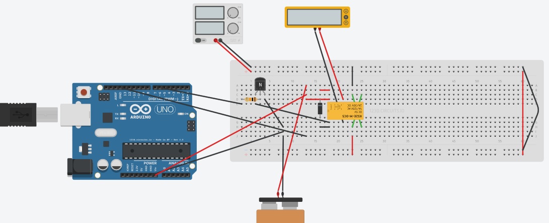

I've attached a breadboard schematic of what I interpreted OldSteve's diagram to mean (I know, I know, the layout's not pretty, but this is just for simulation on Autodesk 123D Circuits). Note that the 9V battery shown as a supply to the arduino will likely just be a wall wart in practice.
I'll note that the code I'm using to run the simulation is supposed to make pin 2 cycle on for 5 seconds, then off for 5 seconds. The problem is, when the simulation starts I am getting -2 V from the DPDT relay (which is OK), but the polarity never switches.
(Note, if I don't put the diode and transistor in, I can get the simulation to properly reverse polarity.)

You haven't attached anything. I hope you don't mean a Fritzing.
Now attached.

I don't know how you interpreted my diagram to look like that. About the only thing that's OK is the Arduino's connection to the transistor base via the resistor. There's too much elkse wrong to quickly list.
And I hate Fritzing diagrams.
You need to look more closely at the schematic, do some research on how to read them if necessary, then try again.
A couple of points to get you started - You've provided no power supply for the relay. You've connected the relay directly to Arduino ground, the connections to the relay contacts are wrong. The transistor is supposed to switch the 0V side of the relay, not the +V side.
And did I mention, I hate Fritzing diagrams! Learn to read a schematic properly and throw the Fritzing crap in the rubbish where it belongs.
Edit: I guess it's Autodesk, not Fritzing, but it's the same thing. If you're running a simulation, you should be able to trace and fix your errors.
Wall of Shame. :confused:
Add all the components in Steve's drawing to the breadboard.
With a hand full of jumpers interconnect wires to components.
As you do, use a highlighter to mark off the pathways in Steve's drawing.
Take a picture of the wired circuit and show it here.

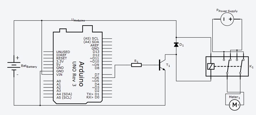

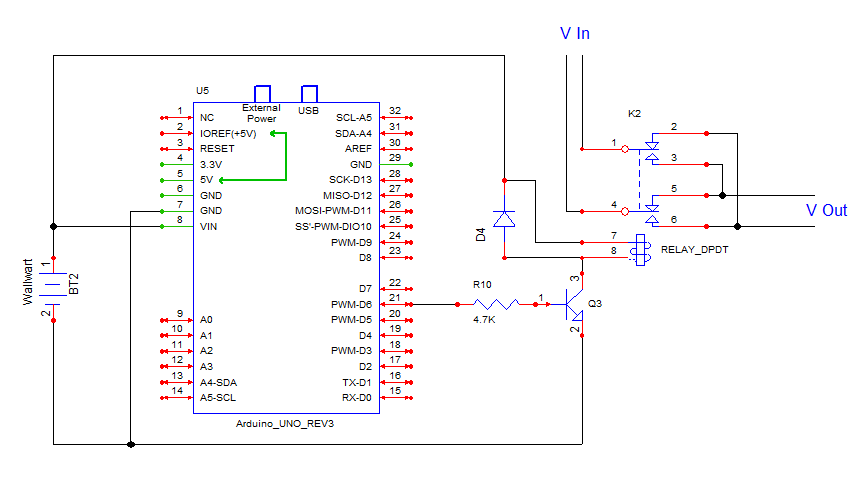

Larry and OldSteve:
See the attached "Fritzing" diagram and associated wiring schematic. I think I've achieved the goal, thanks to your help.
Anything that's still screwed up here?
rhozzy:
See the attached .......Anything that's still screwed up here?
Just one thing - nothing was attached. :slight_smile:
Yeah, I'm apparently getting good at not attaching things :slight_smile: At any rate, the two images should be attached now.
