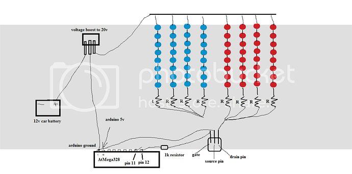

i made a diagram of what i understand it to be. However i tried searching for the IRF3707Z or 7406 ic but to no avail. Please point me in the right direction. is it also availbale from pololu? so i can order everything at once? I tried radioshack and the like and none have IRF3707Z.
I want this done before new years so i will overnight parts however i dont know what to order.
red leds are rated at 20mA and 2.0v
blue leds are at 20mA and 3.3v or so.
which resistors do i need?
I used online calculator and for the blue i got 390 ohm resistor if wired by 4 in series with 8 rows
and for red i got 220ohm if using like u suggested
Thanks for any tips i really appreciate it
Roman

Your schematic is not quite correct.
Make sure to connect up like I have shown - 20V is the top of LEDs in series, finish with the resister going to the Drain pin of the MOSFET, with the Source pin to ground. With this MOSFET you are opening & closing the circuit on the Ground side, and not on the high voltage side.
Connect the Arduino pin to the gate thru a 1K resistor, with a 10K to ground.
Mouser also has 7406's in stock
Your resister choices look okay.

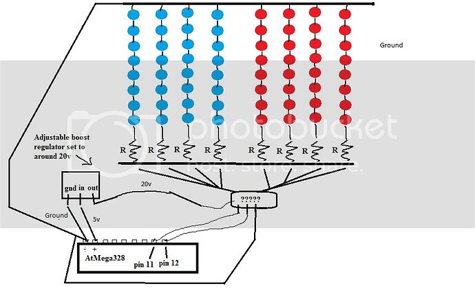

Hi CrossRoads,
sorry to bother again but i am stomped.
I have received all the parts and i am lost as to how to properly connect everything.
I ordered 2 mosfets transistors, 3 7406s and not sure which is better to use and finally got the voltage booster.
Please help me with a sketch. I dont understand how do i connect the second part of leds (blue ones, according to the sketch) if it only has 3 pins.
Please help i would love to finish this by the end of the week if possible.
any suggestions are appreciated
Thanks a bunch
Roman
Here is the current one i just cant understand how to finish it.
You are oh so close! Just needed to show the 2nd driver:
sketch would be simple - I didn't compile this, just writing from scratch, should be pretty close

CrossRoads thank you so much sir.
Ive made a video to show u where im stuck. Iv been trying to modify this all day long and still cant figure out what is the deal.
It seems like led are lit not whether arduino tells them to, but rather the power suply of the battery.
Any ideas?
Thanks so much
Roman
Sorry Roman, was out of the house tonight.
What Mosfet do you have?
PSMN035?
Middle pin is the drain where the resistors meet up.
The riight hand pin is the Source, which goes to 9V-/ground.
Sounds like you have them swapped.
You are running the sketch I drafted? If so pin 10 is an input with an internal pullup resistor.
You can fake it being a switch by connecting/disconnecting to ground.
Disconnected, it is 'open' and the LEDs shouldbe off.
Connected to ground, it is 'closed' and the LEDs should blink on & off.
