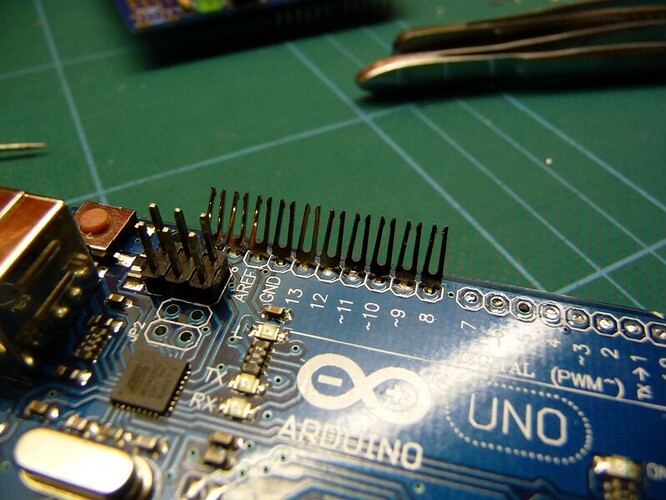

Hi All,
This might make your toes curl!! But I have just added extended sockets and pins to my cheap Chinese copy Uno! The process was not too difficult, firstly removing the plastic shell, desoldering the pins and whipping them out. opening the holes and adding the sockets/pins and just resoldering. The extended sockets mean that nothing touches the USB or power sockets, either.
Yes I know this is not the way to do it, but it makes sence to me, to be able to plug a Uno in to a shield as well as the other way around, in fact having the Uno on top can have benifits. Yes pins can get bent and even short together, but you just need to be watchful, as you are for many aspects of the hobby.
Here's a few pictures.
