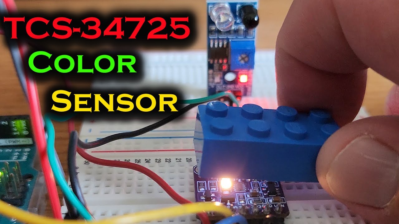

In addition to what @camsysca said, I'd add that color recognition is possible with Arduino, for example:
In your case, I think you should have 6 sensors, one for each hole, but I have no idea how you'd install them (also because you need lighting). I think you could start by purchasing a sensor and doing some testing before.
