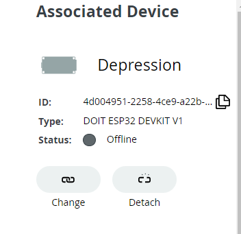

Not Able to select port for ESP32 DEVKITV1 kindly help also I'm in school so use simple language please :smiley:
Also, It says the device is offline even tho i tried different ports on the laptop

now, this is showing up..
nvm fixed i just linked it to my 2.4Hz wifi
