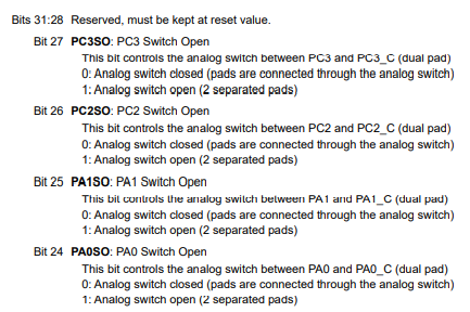

Can t you just unlink those pins ?
(Register SYSCFG->PMCR)
FYI, PC2 and PC2_C are two different pins on the chip package. Yes, you can connect and disconnect PC2_C (for instance) from PC2.
But if you want to use PC2_C - you need to close the analog switch. But internally, now PC2_C and PC2 pins are connected.
If I need still PC2 digital function - the same signal comes out (or in) on PC2_C. So: if PC2 is needed for a function - the PC2_C becomes unusable (even a different pin, signal on header).
What I mean is just: the header signals are often doubled: even it looks like a different header signal - it is actually the same signal (a waste of available header pins).
The PC2_C (and other Pxx_C signals) are only usable as ADC input signals (analog switch remains open). So, you can never use PC2_C as another digital signal. If so: analog switch closed but now PC2_C is the same as PC2.
Actually, clearly to see: J2-77 is just ADC_A3 - no other digital function available on it.
It was my wrong assumption I could use PC2_C as a digital signal, e.g. as an output: yes, it works with analog switch closed, but than this digital signal is identical to PC2.
