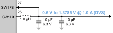

How is the VREFDDR reference ?
In the datasheet, page 134 and 135, they are specific.
This circuit:
afbeelding
With these components:
The two capacitors are to lower the ESR even more.
If the board is made with something different, then it might not work well.
I do not know the reason to choose 3.1V. I assume there is a reason for it.
Thank you.
The schematics of Portenta H7 matches with the PF1550 datasheet. The inductors have the same inductivity.
