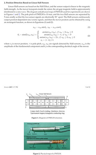

To my understanding the two linear hall effect sensors are separated by 5 mm (90 Degrees Electrically). My current approach is based on the method used in this paper I found online, which probably explained it better than I could. (Screenshot of the relevant section attached)

I have been able to successfully track the slider from ~0 mm to ~20 mm (the distance of 2 PI Electrically / the Pole Pitch), however I have been struggling to come up with logic which could effectively count above 20 (or below 0) as the value becomes -19.99 immediately after 20 (when moving in the same direction). Presumably this is due to the nature of atan2() function and to solve it I would somehow need to make it track beyond -pi and pi.
I have been looking at other's question on tracking atan2() beyond -pi and pi but I can't seem to find a consistent solution.
I have been struggling for so long on how I could solve it with a counter of sorts, which works for position from between 0 - 40 mm but jumps back to 20 when real position is > 40 mm.
I am a novice in electronics and programming so any help would be much appreciated.

  float electricalAngle = atan2(sinProcessed, cosProcessed);
  float moverPosition = (polePitch * electricalAngle) / PI;
  //The Counter below is not working 100%
  if(previousPosition - moverPosition > polePitch){
    counter = counter + 1;
  if(previousPosition - moverPosition < polePitch * -1){
    counter = counter - 1;
  actualPosition = moverPosition + (counter * polePitch);
  previousPosition = moverPosition;
if you really believe there is a problem with atan2(), i would suggest you confirm it by looking at its values. One approach is to capture the max/min outputs and display them.
perhaps you could count the "jumps" (counter++ from 19.99 to -19.99, counter-- from -19.99 to 19.99). then, multiply the jumps by 20 (or 40) and add the CurrentAtanCalculation ..with a little modification for the negatives (half circles)
