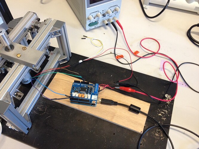

I'm using an ARDUINO UNO R3 too. I can describe my setup if you want :
  • an ARDUINO Motor Shield is on my UNO
  • encoder is linked to 5V and GND pins with green and brown wires and to pins 2 and 3 for the 2 other wires (blue and violet if the colors meant to be standard)
  • the motor itself (red and black wires) is connected to the +/- pins of the motor shield on the B-side
  • the motor shield is linked to a regulated generator delivering from 0 to 12V
I will send a picture of the setup as soon as I can.
Okay, here is my setup (here the encoder is plugged on pins 2 and 3 (blue and purple wires) but I've also tried pins 3 and 4).
I've tried to turn the motor only with my hand but the counter still stays at 0. Nothing happens. Although the setup seems fine to me... I don't see what could be the problem at this point. The optical encoder works properly I think because I managed to count something with serial monitoring with another code (I don't know if it counts well (I think it does) but at least it counts...)
Try the code without the shield. I tested the code without any shield.
Okay, I've tried without the motor shield, just the Arduino, optical encoder plugged on 5V and GND (brown and green) pins and on digital pins for blue and purple wires (I've tried pins 2 and 3 and pins 3 and 4), and the Arduino linked on my computer via the USB, but the counter still stays stuck at 0.

I managed to have a functionning code for counting the encoder, only with the double resolution but it's enough at the moment. I've also tuned my PID controller almost as I want. The last problem I might have is to give a command to my motor so the movement of the motor is sinusoidal as function of the time. I've tried something like :
timecur=millis();
command=60*sin(0.5*timecur);
But that doesn't work, nothing moves...
If anybody has an idea to do this... I keep looking on my side.
@TomGeorge I've read a lot of things on rotary encoders before posting, but now it's solved. My motor is an EMG30. Here's the datasheet EMG30 data.
