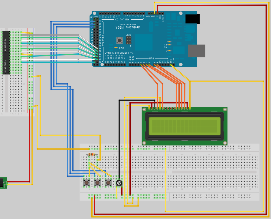

my bad. Quite stupid from my part not to include schematic (attached).
Have you enabled the internal pull up resistors, you need to.
Remove that common resistor in the -ve line of the switches and connect them all directly to ground.
Before I added common resistor this problem occured even more often.
If I'm getting you right then your suggestion is to turn in INPUTS for the buttons to HIGH and turn them LOW to switch hours/mins/sec?
I don't care, it is wrong remove it and lets get to the real problem. Make sure that common line is connected to ground.
No, use pinMode on all the three pins to make them into inputs. The do a digitalWrite(pin, HIGH) on each one to enable the pull up resistors.
Then you will see HIGH when you read an input with the button not pressed and a low with it pressed.
Will do, thanks
Just looked at my source, internal pull-ups where enabled. So there must be other problem.
Yes got rid of that resistor yet?
Yes
OK, I would try and connect the common ground in a more direct path to the ground.
I would also add some decoupling caps to the power supply of the LCD.
Are the buttons working but sometimes you get false signals?
If so then You might need a stronger pull up resistor than the internal ones as those are quite weak. Try a 4k7 from each input to +5V. Also try a 0.1uF from each of the inputs to ground.
