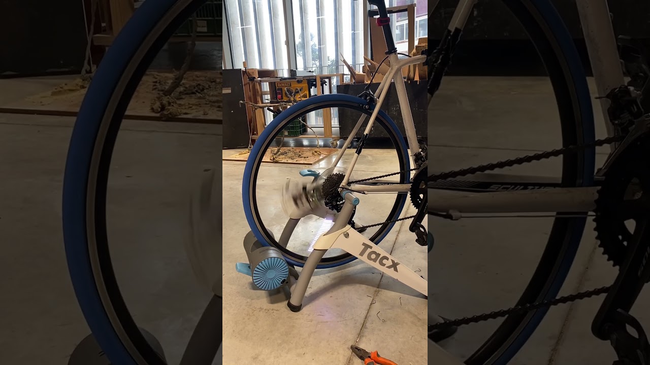

Hi i am following this tutorial:
using the same wiring and so
although i added a led to indicate the hall sensor being triggered and an hall sensor
the reason is for mw to be able to make this device interactive and in the end ride on a trainer on a show in my art school
hope this code thingy worked
so, what is the problem? everything seems to be logical dn working.. but yet i am bothered by that the time it takes to "show" an image that is 100 pixel wide is 1 second!
i think there is something i am missing.. maybe there is a limit of how long a picture can be for this work..
maybe my code is slow..
this is the part i am asking for help
because in 27kmh the bike is around 7.5m/s and that is a revolution in 200 milliseconds ( if i got this right ) thanks a lot and sorry if the topic/forum is not tight, will fix and edit if needed
thanks again
the code is added:

Hi again, so I assembled it on the bike and still it is not visible.. what would be a good graphic to test this mechanism? Maybe my graphic is too much or too little.. do we need to calculate pixels as cm and try to achieve a full circle of image?
Adding a video of my latest attempt:
Thanks!

so i followed the:
but with minor changes:
  1. i used esp32
  2. i decided to use the pull up inside the pin 2 of esp32 instead of a external resistor
  3. i did switched to a reed switch instead of an hall sensor (like the instructables suggests)
  4. i did not use the capacitor but will do later this week
still not quite good results.. going to try to use esp32 wi fi functionality to control and find the sweet spot from afar, and then learn how it can do it by itself..
so after another huge disappointment as even though wifi adjustable
and making the delay time to be as fast as possible i still wasn't able to get a good result
