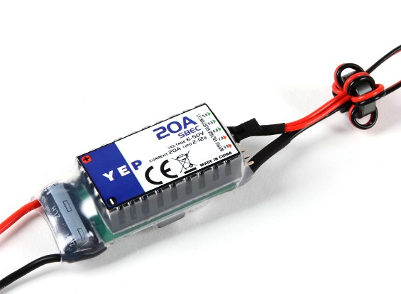

You need to find a way to deliver a stable supply to the servos. A lithium polymer battery can supply a high current but you will need to use some type of voltage regulator ( or multiple, preferably switching regulators) to supply 5-6v power to the servos.
In the RC world they use things like this for planes with many or high current servos. The input power would be from a good lithium polymer battery.
Instead of one big regulator you can alternately use many smaller ones one for each servo or whatever.

So, if I understood correctly, I connect lithium polymer battery to this voltage regulator and on the output of the regulator I always have for example 5.5V, yes? And there is no option to power it from the AA batteries? I ask, because if I damaged servos, I thought that the problem would be too big current;) and the solution for these too thin cables is just soldiering thicker ones?

As for the how to get the right voltage.. because it's a quadroped and a heavy battery will probably be an issue ?. I would get a nice light lithium battery and some cheap switching regulators.
