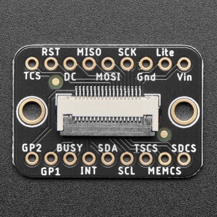

The breakouts between the multiplexor and second BME280 are Adafruit EYESPI FPC connectors:
I'm thinking of using something similar to carry power from the USB mains adapter to a USB breakout. I'd then split that to the I2C devices etc and another USB breakout to convert it back to a USB cable to connect to the ESP32. I could even use the same cable, it just means the pin labels wouldn't match.
