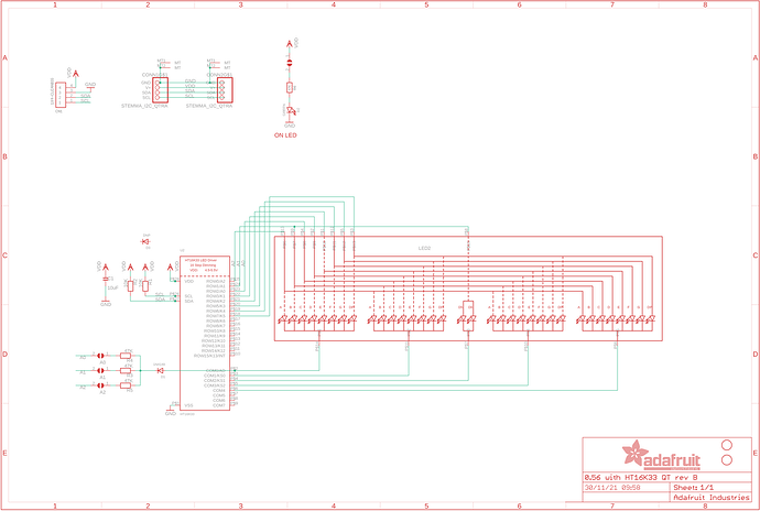

Thanks for your reply. The voltage difference didn’t even cross my mind. Here is the schematic for the Adafruit I2C backpack on the segment displays. Looks to me like there are 10k pull-up resistors on SDA and SCL

It turns out that the Adafruit BME280 sensor modules have level shifting circuits built in. So you would have two such circuits and four display modules, each with their own pullup resistors. I'm gonna have to draw this out. It's very complicated.

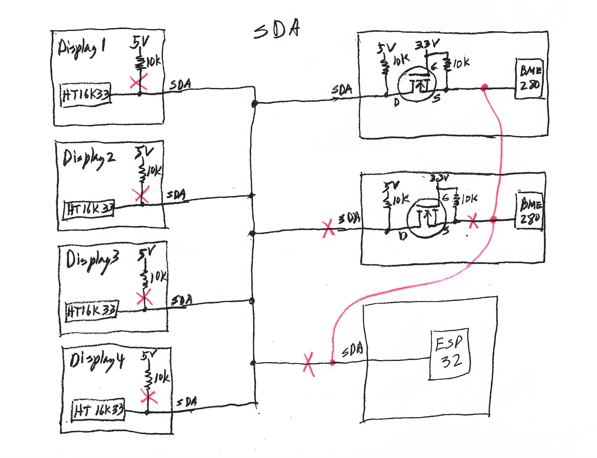

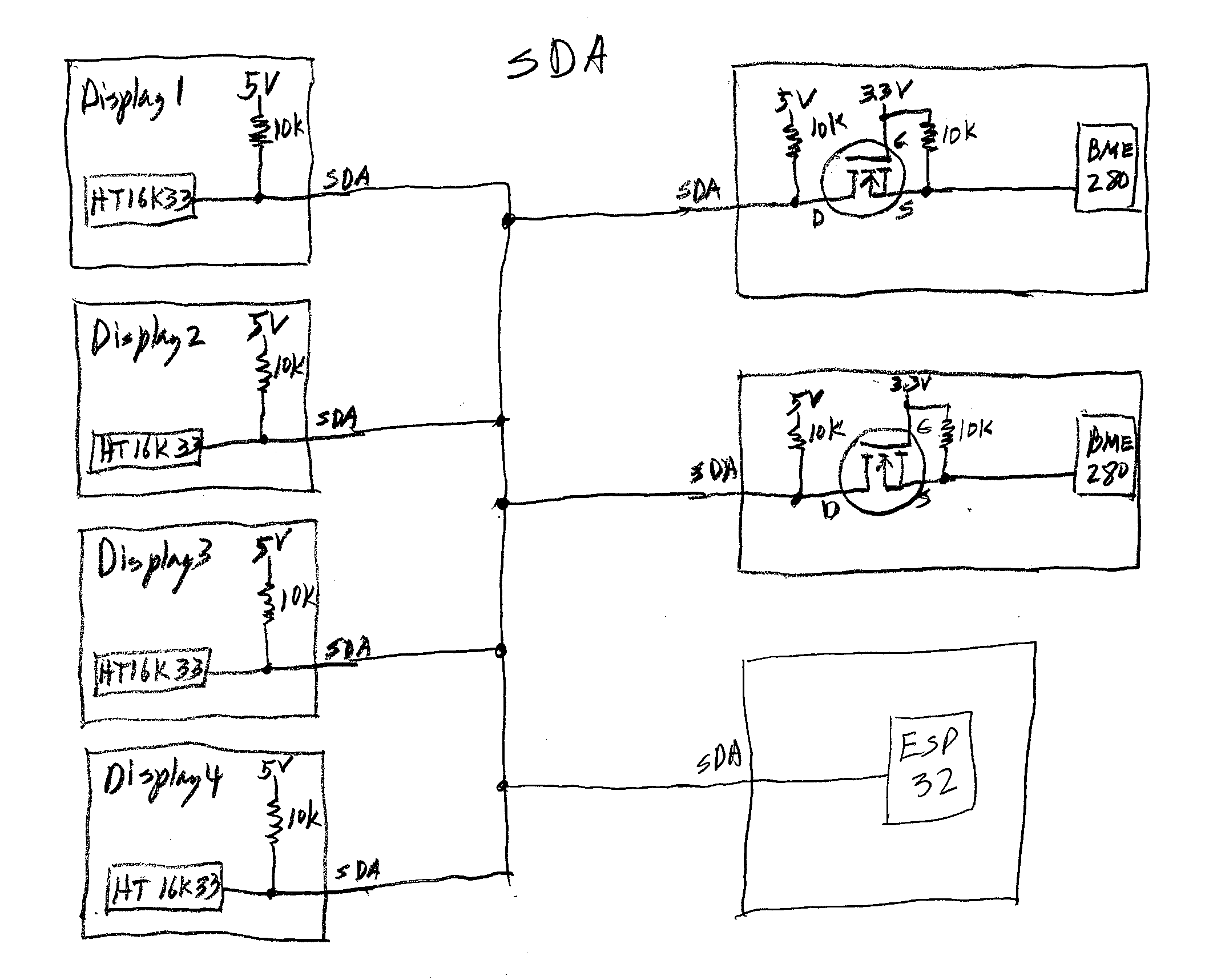

Ok, here is the schematic of the SDA line with what I think your parts contain. SCL would be the same.
There are a total of six 10K pullup resistors to 5V, plus two 10K resistors to 3.3V. In effect they are all in parallel. The typical "strong" pullup for I2C is 4.7K. But this is way stronger. The result is that whichever chip is driving the line has to sink a lot of current to bring the line low. I figure it would be 3.66mA, versus 1.06mA for the typical single 4.7K pullup. I don't know whether these chips can do that. And this still leaves the ESP32 pin unshifted, which may or may not work.
All you really need is one 10K pullup to 5V and one 10K pullup to 3.3V, resulting of 0.83mA when pulled low. The changes shown below in red would be needed to achieve that.
I don't know whether those changes would be practical on these boards - just physically being able to do it with all the small SMD stuff.
There are other BME280 modules online which don't have the 3.3V regulator or the level shifting circuits. They just have pullup resistors which should be easy to remove. They would have to be powered with 3.3V, which could probably be done from ESP32 GPIO pins. But you would still need one level shifter each for SDA and SCL, which would require one dual BSS138 chip. And you would still need to disconnect three of the four pullups on each line on the display modules.
So it turns out that the I2C addressing may work out, and the pullups can work too, but require some thought and rework of the modules. Anyway, I think you have more work to do in settling on the final circuit. And you might want to consider how many displays you really need.

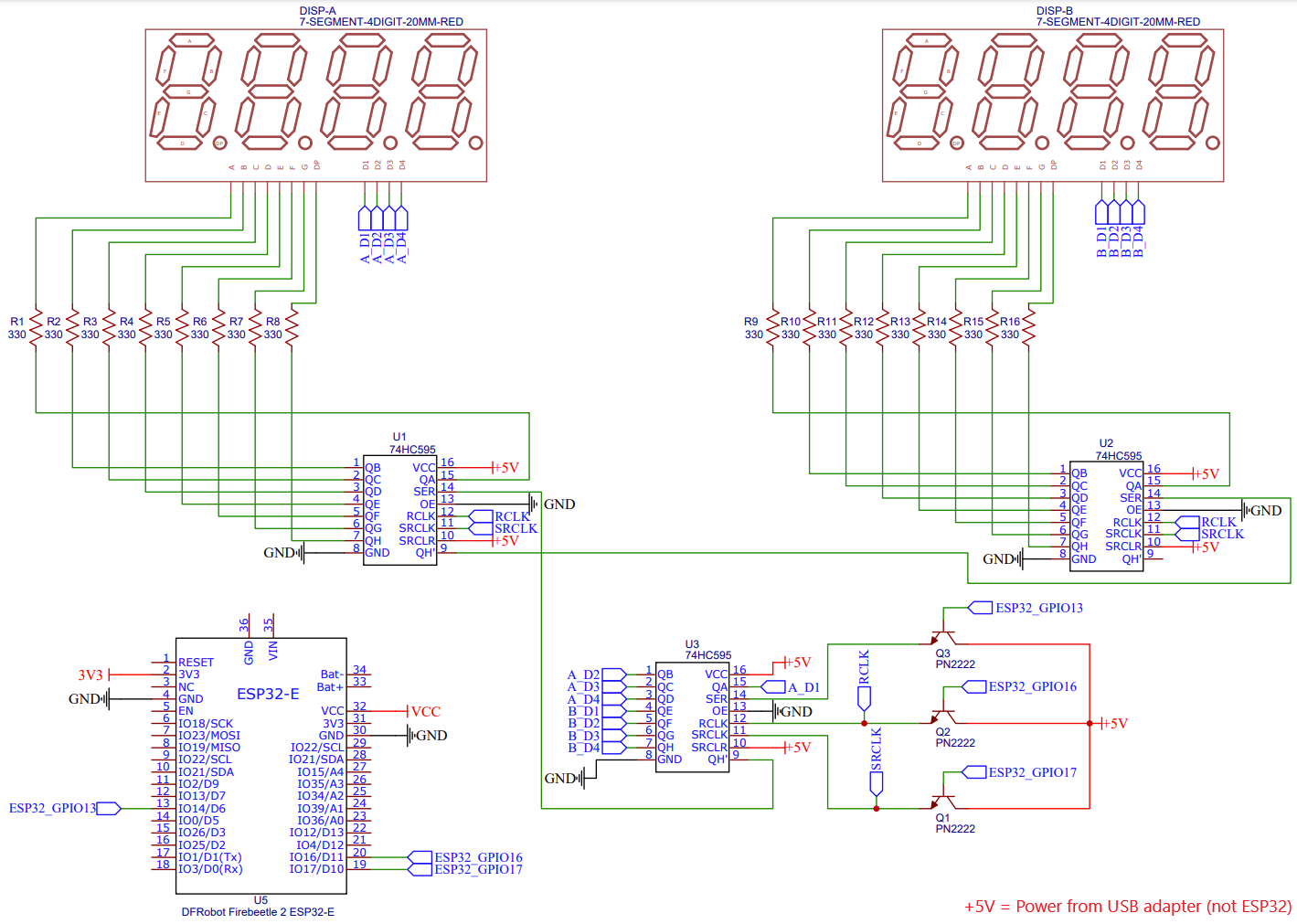

I've dropped down to 2 displays to simplify things, but my theory is to push 3 bytes to the serial input and then set the latch pin high. This way I believe I can control which digits and segments are lit using just 3 GPIO's on the ESP32. If I've implemented the transistors correctly I'm hoping this will resolve the issue of using a different voltage. The 5V would be supplied via a USB breakout board which I could then connect back to a second USB cable to power the ESP32.
I would still need to add the two BME280's via I2C at 3.3V, some buttons, single LED's and possibly a water level sensor of some sort which I think is achievable with the remaining pins. If this will work I think my main challenge will be fitting it all in a 3D printed case with through hole components :frowning:
I'm not sure the 595 can be used for the common cathode or anode. You should look at the datasheet for the maximum current on any one pin, and the maximum current through Vcc or GND. Also, this setup would only let you light up one of the four digits at a time. Are you planning to multiplex them?

The common cathode pin of each digit will have to sink the current sourced through all of the segments on that digit. If you don't use the decimal point, that would be seven segments. That means you would have a maximum per-segment current of 5mA, or 35mA in total, if the character "8" is being displayed. Transistors are typically used to get around such limitations. On the other hand, if you use efficient displays, you may find that 5mA is bright enough.
But we need to work on your transitor drive of the 595 inputs. Actually, if you could find a few 74HCT595 chips on Ebay, you could just drive the inputs directly from the ESP. They only require about 2.2V for a high input. But that chip is no longer made as far as I can tell. There's a 74AHCT595, but I don't know what exactly that is.
So you will be shifting out three bytes of data to activate one digit on both displays. I think that should be doable. I'm sure the ESP will shift each byte out for you automatically once you start it, so you don't have to attend to each bit. Also, it's only the latching that really needs to be done on a timely basis. If you have to do an update every 2ms or so, I think the ESP would have no problem with that. And you could set up timer interrupts to do the shifts and latches in the background.

I think the 595 shifting circuit should work, but I think you should just drive the inputs directly, with no transistors. You may have to insert a rectifier diode in series with the Vcc pins of the 595's to make them more receptive to 3.3V input, but I think that's better than the transistors.
