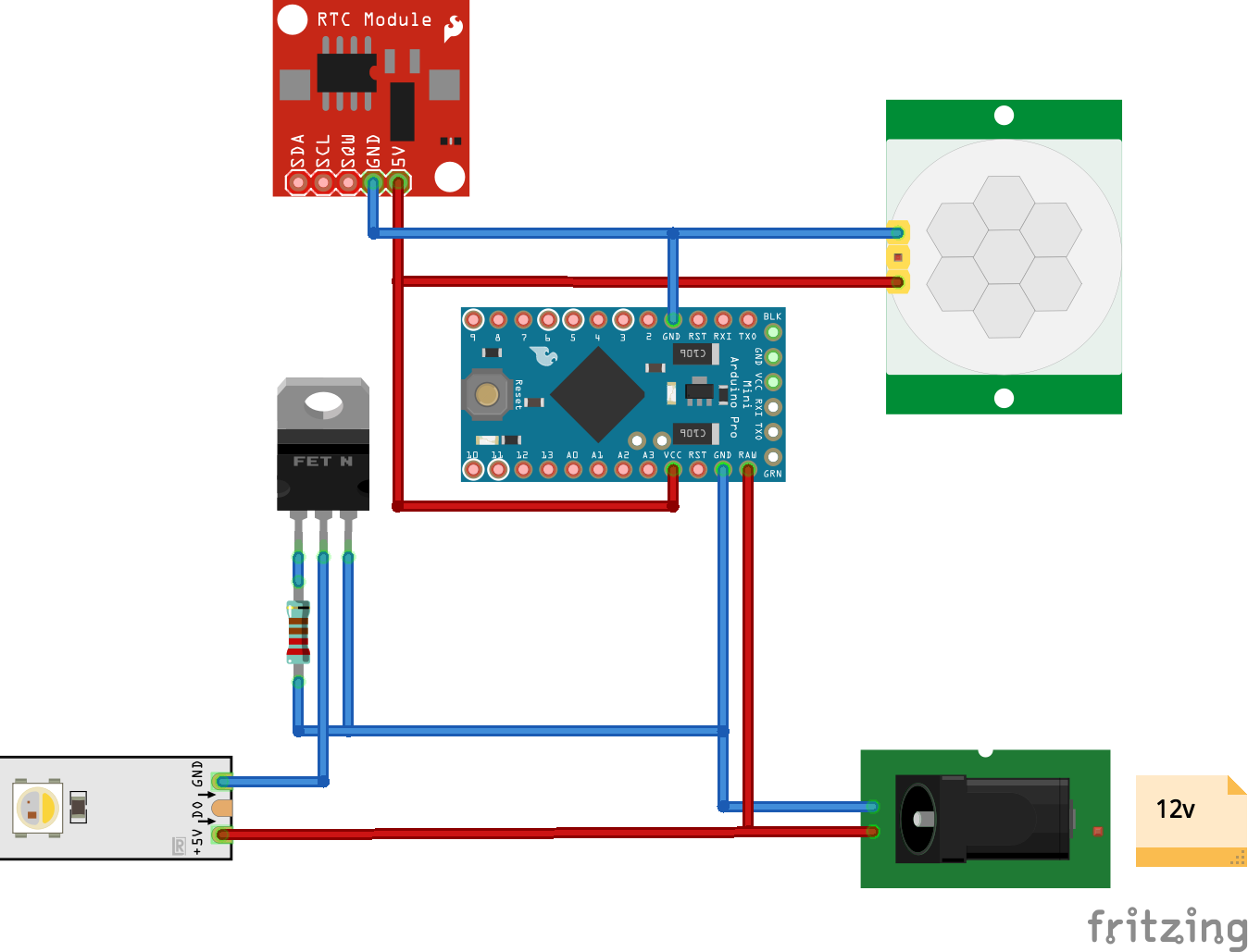

I'm making a motion activated LED strip as night light but I'm not sure about the exact power wiring
Replacing the UNO with a pro mini (5v) and with a 12v led strip and a 12v power supply I fried the board last night. Not thinking clearly, I ripped away the wires before checking it. But most likely I messed up the grounding. (And yes, I connected the 12v to RAW).
I got a new board and this is how I plan to wire the power:

You mostly messed up the connections to the MOSFET.
Gate not connected to D9.
