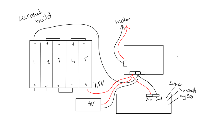

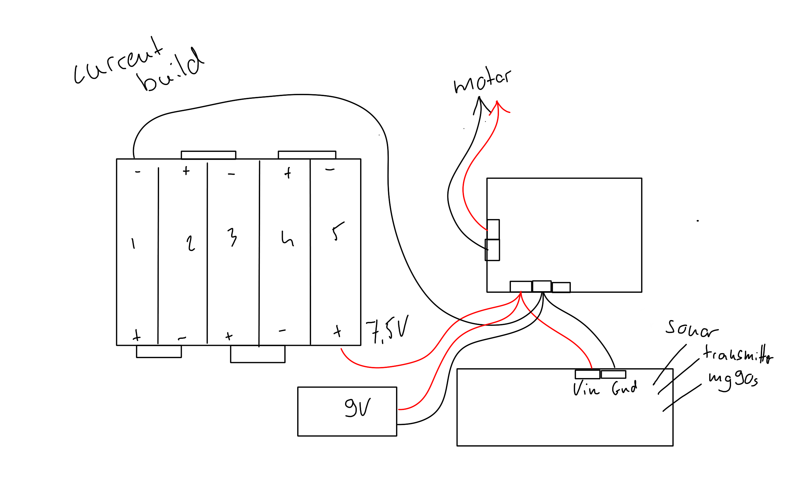

Here are some basic schematics.
The grounds of the Arduino and the driver board will need to be connected. There are 3 options for the +ve rails: Power the Arduino from the board's 5V output, power the board from the Arduino (but then you are limited to 5V and very limited by the current limitations of the Arduino, or power the board with your 7.5V and the Arduino with its own supply.
Even these little DC motors can draw a lot of current at stall.
A 9V battery has very little energy stored in it and very low current supply capability due to high internal resistance. It will get exhausted in short order. The 1.5V alkaline cells are better and they are used in toys all the time. Best would be a LiPo pack 7.2V nominal, which many RC car places will have. Alternatively, NiMh cells are close in voltage but do fit standard cell holders if that is important.
A good reliable power supply is important. One reason is that you may drop voltage so much that the Arduino does a brown out or glitches. Another is that these simple DC motors do produce interference and that may affect your radio.

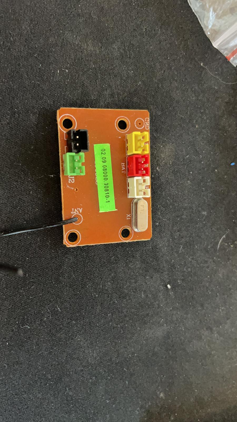

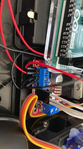

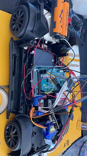

Here are some pictures for reference, but I think I explained it all pretty accurately. The Mega2650 will be swapped for a NANO v3 because its way too big to make it fit with the body on.

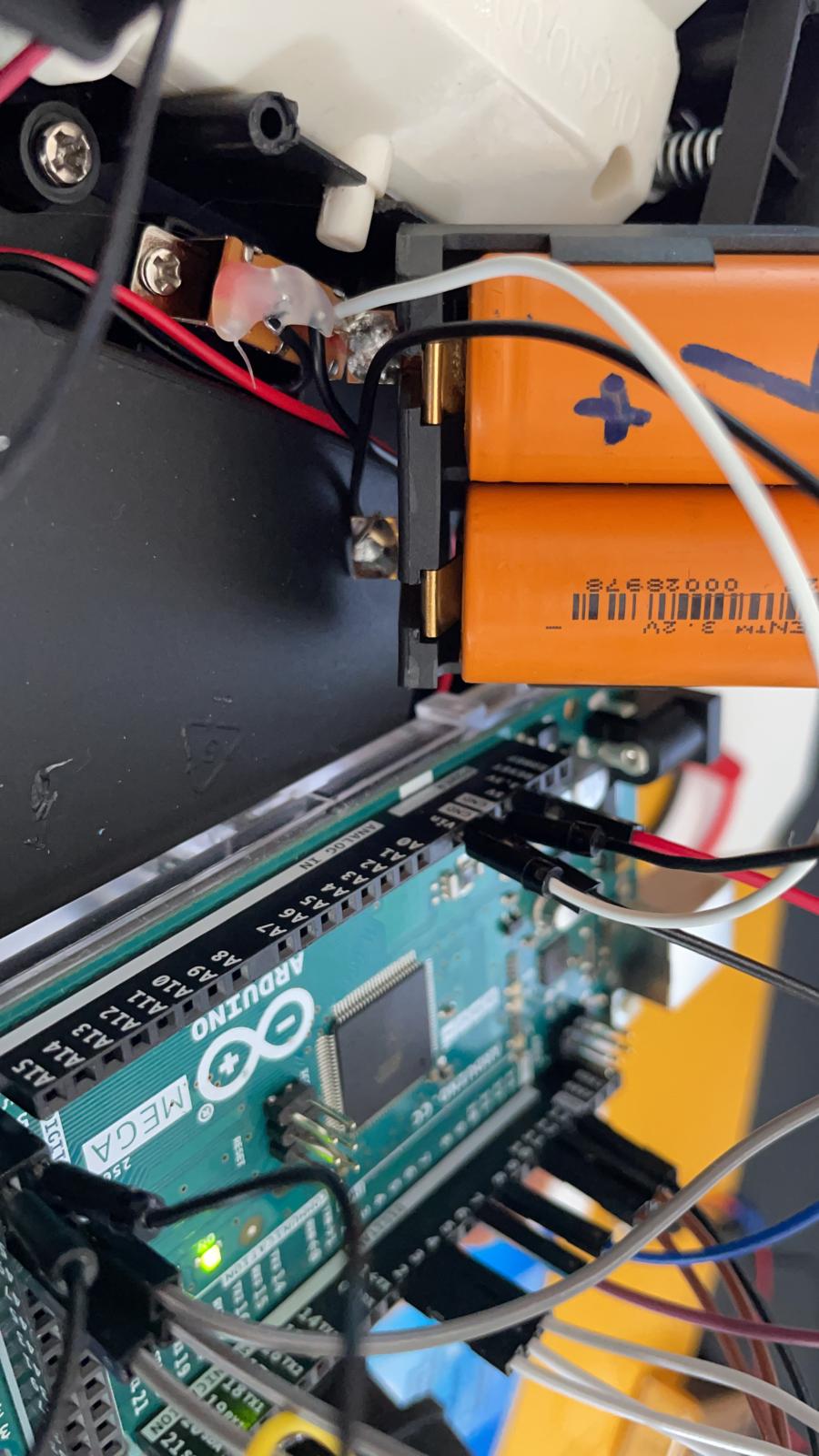

Finally, in picture #2, what is the white wire and the clearish blob on it?

Finally, the white wire is the positive terminal wire from the LiFePO cells and its just running next to dried hot glue. The two share nothing and just tuched there by coincidence. That hot glue was factory and i think it was applied to preserve the solding on the on-off switch's negative terminal wire. But like I said, it was factory, I didn't do that.

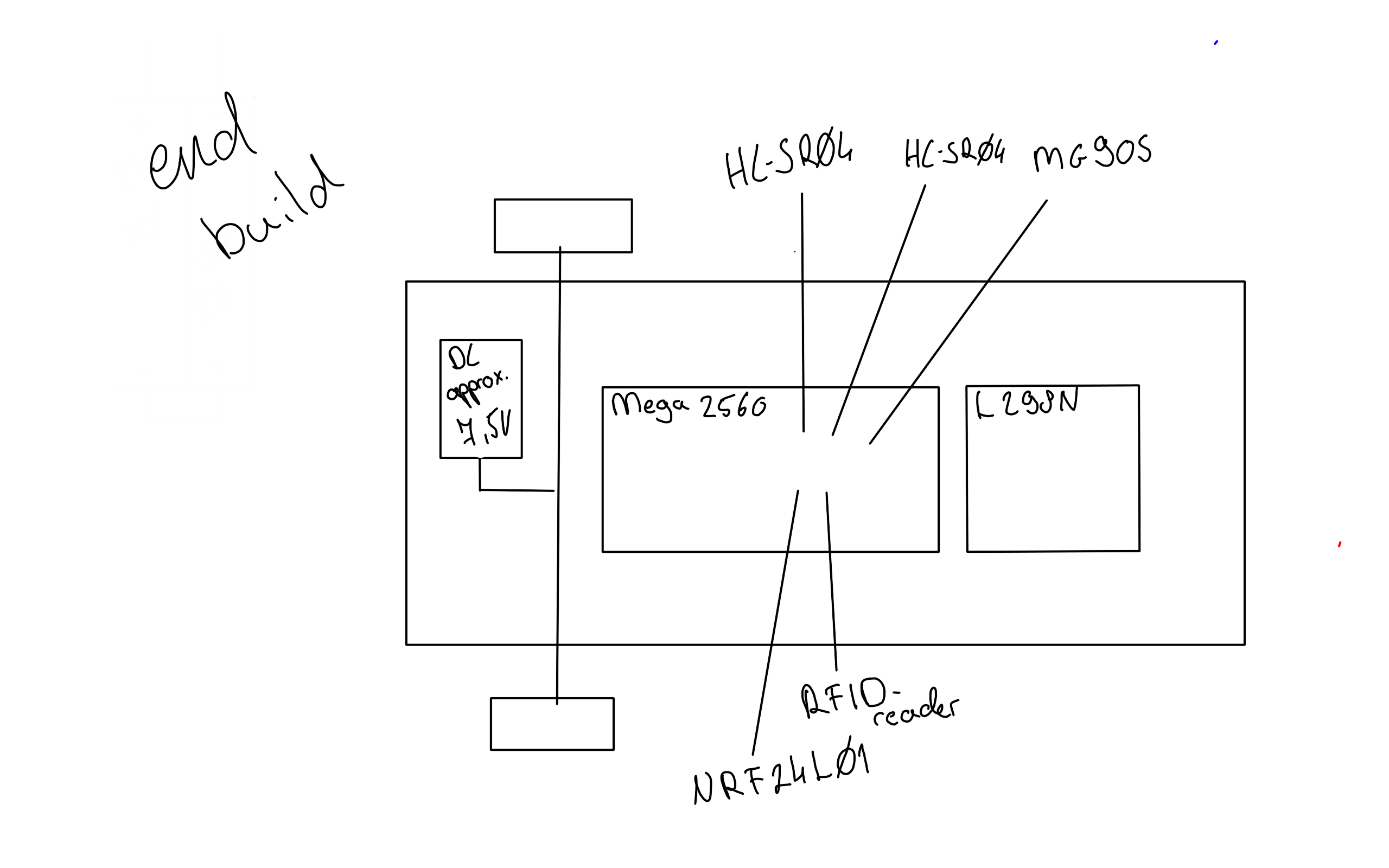

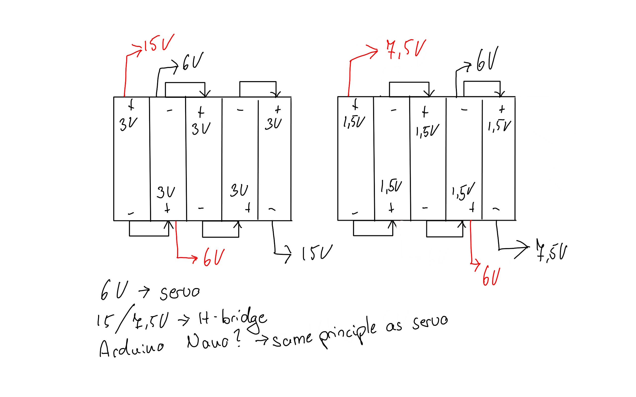

I drew some scematics for the 'tapping' desperado. Is this rougly what you mean? BTW, I don't know whether I would need 2 grounds or just 1 for the cell pack. I don't actually know whether I even drew it right, it could be completely wrong.
Would it then be possible to tap the 7,5V cell pack at 6V to power the servo? I guess i will just try it and measure the input on the Hbridge, see if it really affects stuff. It's theoretically the same principle after all.
Also, the cutting of the wires between cells 2 and 3 sounds rather intriguing. Is it also possible to purchase rechargeable 3V cells? Do these even exist, in AA form? It would be a huge waste to use them for testing, run them empty and spend 50 euros all over again for demonstration day.

Pictures:
The board where EVERYTHING was connected.

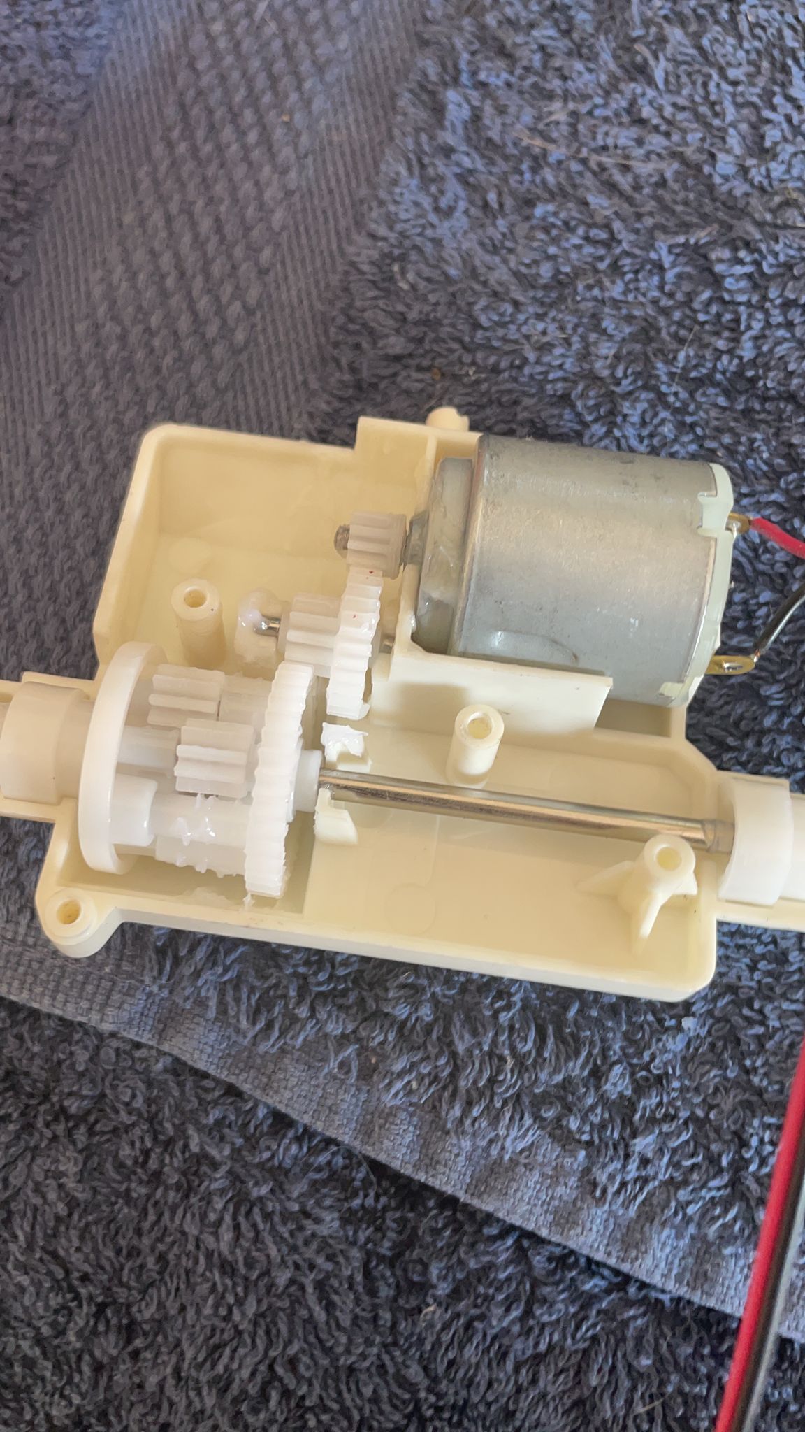

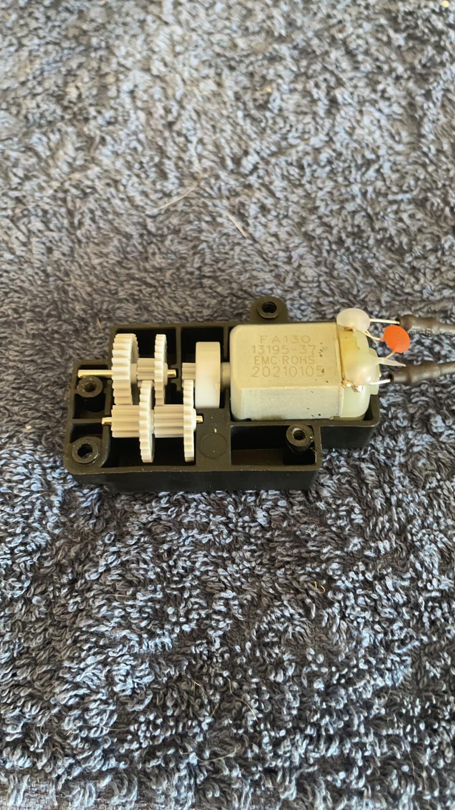

The motor which I'm currently still using, because I have 0 interest in designing an own 'gearbox'.

I have created a diagram of the cells in a pdf so you can zoom into it, etc:
The 6V tap could power the servos. The 9V tap could power the H-bridge.
Cells diagram.pdf (62.1 KB)
If you use 1.5V cells, same principles will apply. Just tap between cell 4 and 5 to get 6V.
If you are providing the Arduino an unregulated power through Vin, you will need to give a 2V or so overhead for the voltage regulator to work with. So, powering it from 7.5V to 12V is doable.
You would still need a way to switch the power on and off to the motor.
The motor looks pretty small and I bet it would work from 5V to 7.5V. Much more may fry it.

  3. I re-soldered the 10Mu capacitors between the + and - wires of the nrf24l01 transmitters. I suspected something might be off with the signals. I did all this because the negative wire of the transmitter broke off at the solder at one point during testing. It was low effort so I just did the positive wire too and the receiver aswell. Couldnt really tell the difference this made, but it reassured me.

Having the capacitors across the motor is a highly recommended practice. I noticed that on the pics, so didn't say anything more. Glad you checked/re-did the solder joints.
