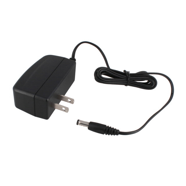

Buy a 9V 1A adaptor like this and plug it into the barrel jack

If you have an adaptor like I show in post #5 then just plug it in to the barrel jack.
If not then +9V goes to Vin and -9V goes to GND
