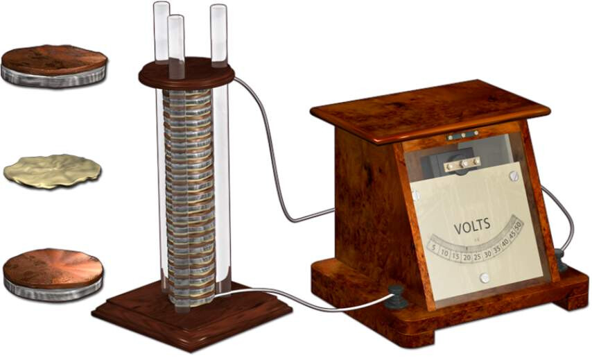

It's the modern version of the Voltaic Pile.
Pad soaked with lemon juice?
like this?
The cell has a nominal capacity of 5000mAh
I prefer the burl oak housing.
