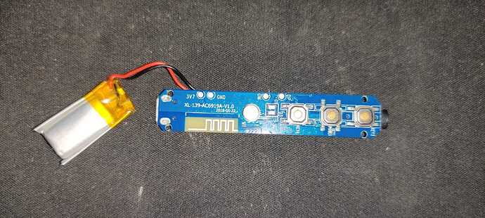

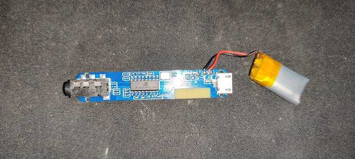

I have a bluetooth music receiver which has a battery and can output music though a 3.5mm jack and can be charged through a micro usb port. It has 3 buttons 1 for power and 2 for next/prev or vol up/down.
I want to modify the circuit, remove the battery and when I connect power to the charging port to automatically turn on without pressing the power button, i thought about shorting the power button but if you keep it pressed it turns on and after a few seconds it turns off. How can i change the circuit in order to give a short signal to turn on and then stay on while there is power connected. I attached the photos with the board and here is a link with the product from aliexpress.
I have a little Oontz my brother gave me years ago. To get around the On / Off button you need to know it's scheme in the circuit. Use a DMM and measure across the button under normal conditions (unit off). Do you measure a voltage open circuit? Most little devices like this have a normally open push button tactile switch. Normally that switch makes a connection to common (ground). ON my unit I need to hold the button in for a second for On and then a second for Off. If this works like I mentioned, using an internal pullup and the switch makes ground you may be able to place a transistor like a 2N3904 or 2N2222 across the switch. You need about a 1 second pulse which can come from a One Shot. The One Shot gets triggered when you Exrernally power the unit, it generates about a 1 second pulse which turns on the switching transistor for about 1 second simulating a 1 sec button press. This is all easier said than done making things fit. You could also use a micro to get the pulse but a simple 555 timer would work.

Can you please draw a lil schematic on how i should put the transistor? Yes it is like that, you need to press the button for around 1 second in order to turn it off. I looked at transistors but I didn't understand properly how to place it I'm not very experienced with electronics
I wouldn't assume this is possible without checking if the chip on the board can survive 5V. It may be
relying on the LiPo cell to provide a safe voltage. Try googling the part number on the chip plus the word "datasheet"
A relay's contacts in parallel with BT rcvr's power button wouldn't require acquiring any in-depth knowledge of the circuitry beyond there.
Regardless of how you get around the switch you still need to hold for at least one second, mine takes a little over a second. Be it a relay or transistor you still need some form of one shot which triggers when power is applied. Did you measure as I suggested and what did you get?
