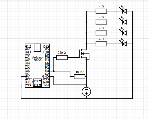

Now, I would like to build a sunrise alarm clock using 4x1W leds (3.6V 300mA each) controlled by an arduino nano. I've done some research and came up with the following diagram. Before actually ordering the parts and building it, I'd appreciate if someone could check my circuit ? :slight_smile:
The MOSFET would be an IRF520N. I'm using a 4ohms 2W resistor before each of the LED. Most of similar circuits I saw didn't use a resistor before their LEDS, but I believe that it had to do with the fact that they were using 12v led strips with 12v power, so they probably didn't need one. Am I correct ?
About the 10k resistor, I've read here that "it will help to switch off the MOSFET completely when the I/O goes to a low state.". I won't argue with that, so I added one. But I have to acknowledge don't I really understand why. So if someone could explain it to me, that would be awesome =)
Missing from the diagram is an RTC module.
Thanks a lot !
(I couldn't upload my diagram directly on the forum so I uploaded it here)
Wrong choice. You need a logic level MOSFET, such as the IRL540.
LEDs are current driven devices, and the current must be limited to safe values, either by choice of appropriate resistor, or using a constant current power supply. The Arduino 5V output cannot be used.
Please describe the LED power supply and your reasoning. 4 Ohms is almost certainly too low.
It is generally required to prevent the gate from floating when the port pin is not set as OUTPUT. It should be connected from the port pin to GND, not from the MOSFET gate to GND.

If your LEDs are really 3.6V, then 4 ohms would be about right for 300mA. Or I guess 5 ohms would be closer, or 4.7 if they make one like that. But I don't think they need to be 2W. Half-watt should be enough (1.4 X .3).
But the 5V supply should be connected to the 5V pin of the Nano, not Vin. And you need a ground connection for the Nano.

Am I using the 5V output ? The LED power supply should be an external 5V2A power supply.
My reasoning is just that my LED have a 3.6v forward voltage and I'm supplying 5V at 300mA. So (5-3.6)/0.3 = 4.667. I rounded it to 4ohms. Is that the issue ? Or am I missing something ? =)
I've made the change to the original diagram.
They should be, the specs says 3.2-3.6.
I totally miss calculated the power consumption for my resistor. Thank you for that !
Here, I'm guilty of wanting to go too fast. Thanks for pointing it out. I've updated my diagram with every comments I've received so far.
@warkorentin
Like this:
You can connect +5V to the nano 5V pin but be very certain that NOTHING is connected to or will ever be connected to or accidentally connected to VIN.
Round up instead. 4 Ohms leads to 350 mA, which is out of spec, according to your statement.
However, the linked product page does not seem to specify the maximum current. 1 W at 3.6V = 278 mA, maximum. Good design principles require staying below that value. A 5.6 Ohm resistor would lead to 250 mA, which is a reasonable choice.
A comment on that store page also mentioned 3.3v at 330mA. I've found similar LED on other website and overall the specs were the one I gave initially. Although I will follow you advice and go for 5.6 ohms.
Which is roughly equal to 3.6V at 278 mA.

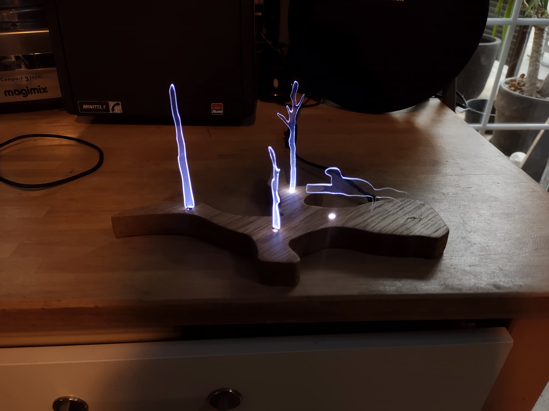

17 days later and the alarm clock is done !
Have you tried soldering to the tabs yet?
Soldering to the tabs went well ! And the small heatsinks that I bought did a wonderfull job in keeping the leds' temps in check.
I've also added a switch the to circuit in order to turn the leds on outside of the programmable hour. I set them to an extremely reduced power level to avoid overheating in case they were powered for an extended period of time.
The final product is a gift for a friend working in biology conservation on Giant otters. Hence the aesthetics. The wood piece is supposed to be shaped after part of the lake she is working at. Here are a couple of pictures if anyone is interested.
(the trees aren't glued yet)
Thanks a lot to each one of you ! Your advice were instrumental in helping me figure out what I was doing. Now, onto the next project !
Thanks again !
