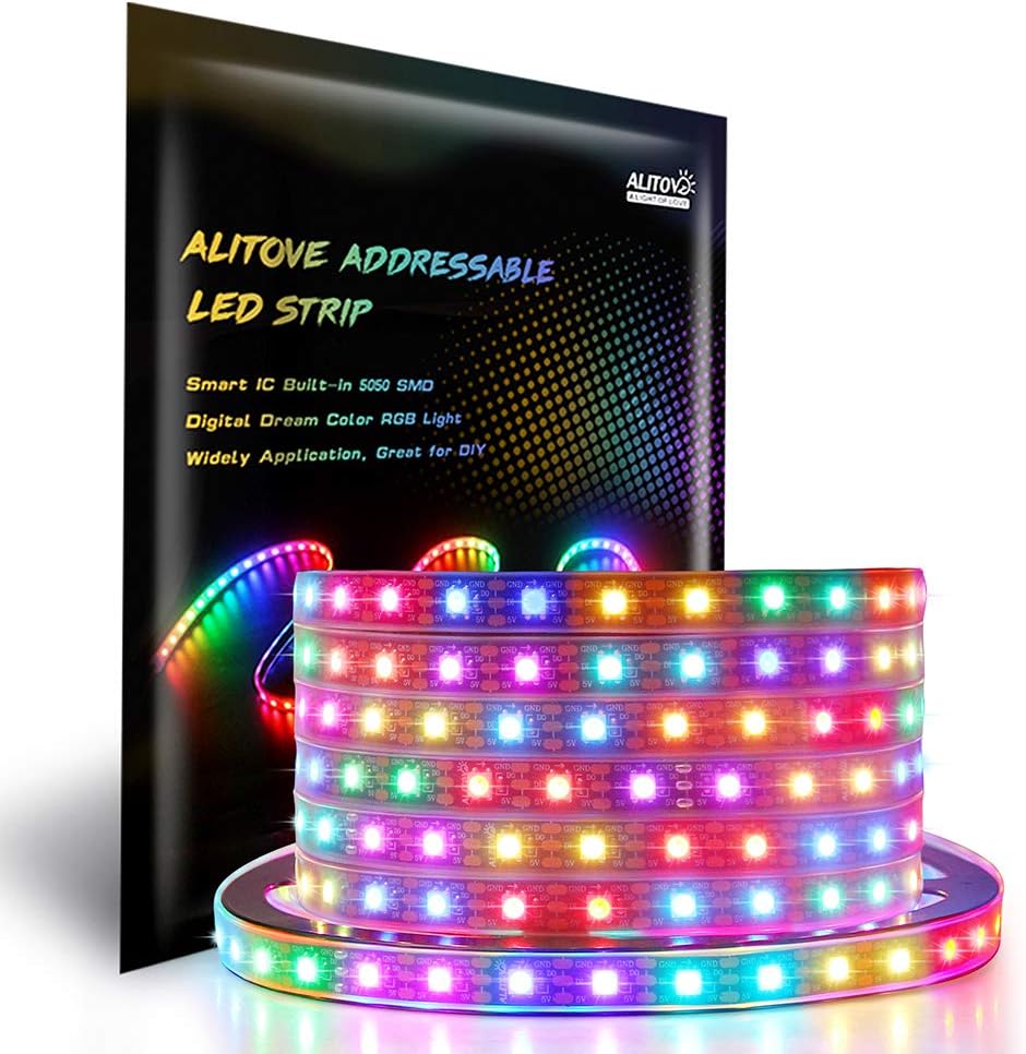

I have this exact pair of LED lights. I have the 5 metre pair and I'm looking to light up the whole entire 5 metres, how can I do this using my arduino uno? (I'm new and scared I might do it wrong or blow something up) heres some info:
Product Name: WS2812B LED Strip (Black PCB)
Voltage: DC5V
Quantity: 30LEDs/M
Power: 6W/M
Package: 5M/Roll
Mode of connector: Red Wire 5v, Green wire DI, Black wire GND
BOARD:
Uno R3 Controller Board
LINK:
Have a look here:
  1. Get a big 5V power supply. Plan on 60mA for each LED in the strip when full bright is commanded.
  2. Do some research on using Neopixel library or the FastLed.h library to send data to the strips.

Hello, I tried this:
(see images)
and got a small amount of light, then they went off. I hooked up my 9V1A power supply plug to the Arduino Uno board and that didn't work, I followed the wiring diagram and still no luck.
Black wire went to GND, Blue to ~5 and red to 5v. What am I doing wrong?
You need a dedicated 5V power supply for the strips. You can not power the strip from the 5V pin.
300 leds times 60mA equals 18 amps (worse case, full white for the complete strip).
150 leds times 60mA equals 9 amps (worse case, full white for the complete strip).
[FIXED] Got it working after running some updated code. Thanks everyone for the help!

Voltage: DC5V
Power: 6W/M
Package: 5M/Roll
So 30 Watts (6W/M * 5M). At 5V that's 6 Amps (30W / 5V). Get a 5V supply rated for at least 30 Watts or at least 6 Amps. Higher will cause no harm.
