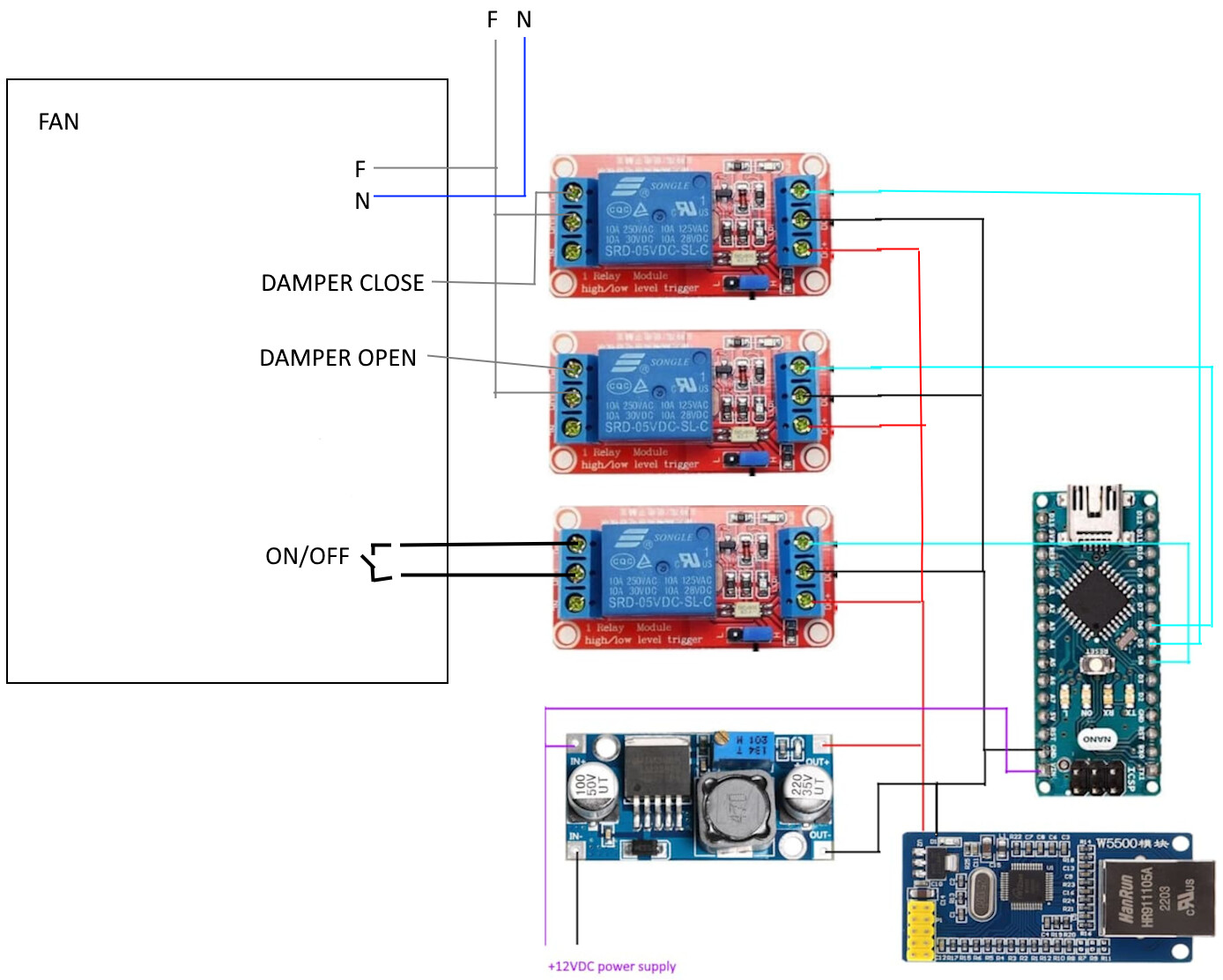

I've wired my setup according to the attached drawing.
However, I frequently lose my MQTT connection whenever a relay switches on or off. The connection doesn't restore until I manually press the reset button on my Arduino Nano.
I suspect the issue is related to voltage spikes, as the MQTT connection remains stable when the relay board is disconnected.
Would you recommend using two dedicated LM2596 DC/DC converters to separately power the relay board and the W5500?
Is suggested a dedicated DC/DC lm2596 to feed power only at the relay board?
The relay module pictured appears to incorporate a reverse-biased diode across the relay coil already. However, for whatever reason it may not be sufficient(burned out, whatever). First, I would attempt putting a diode across that coil to suppress whatever is hitting your MQTT connection. If that doesn’t solve the problem, then yes, installing a second DC-DC might be the simplest solution.

What is the relay switching?
Powering the relay's coil (about 72mA) through the Nano's 5 volt regulator after it has dropped 12V to 5V will cause it to dissipate about 1/2 watt, may be enough to overheat and shutdown.
  • What are the relay contacts controlling ?
The circuit in the lower right corner has no ground connection. Trouble is unavoidable.
Re-check the drawing. Powered direct from the LM2596.
the relay feeds 230vac to a damper actuator
I’d like to think our OP’s black pen just ran out of ink when he drew the connection from the 2596 - side to the 5500 module. But hey, he can elaborate.
I checked with tester, the IN GND and OUT GND are shorted....

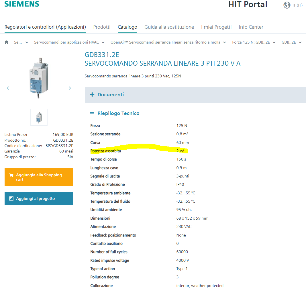

What is the actuator's current (Amps)? Do you have any kind of snubber or surge suppressor on the actuator?
Your 5500 module has no GND. For that matter, you’ve not shown any data connections for it, either.
edited the image... THe data connection isn't showing... I followed the standard scheme

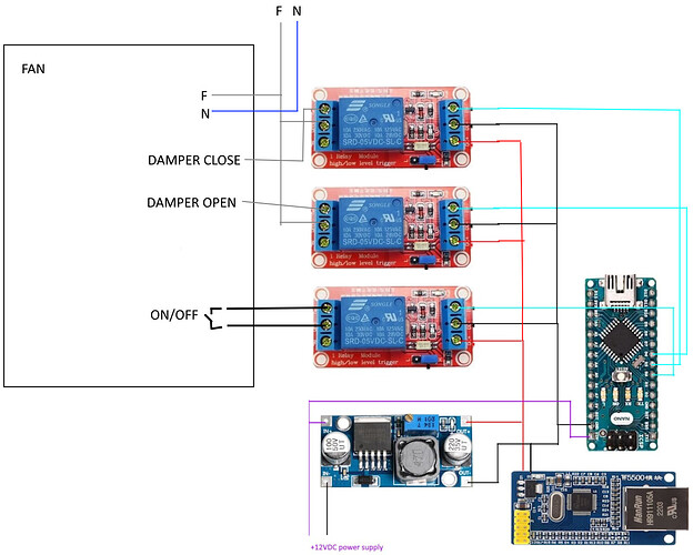

I've updated the diagram.
There are 3 relays; the one controlling the potential-free contact causes no issues. However, the two relays that switch 230VAC are causing problems.
Another piece of information: the cables between the Arduino and the relay board are very short
For troubleshooting --
  1. you could run the Nano and wifi board from 5V_USB and run the relay board from the 12-to-5V unit; see how that goes
  2. add a bigger capacitor on the 12-to-5V output (470-1000uF)

I tried disconnecting the 230VAC load from the relay, and everything worked well. So, I believe the problem isn't the relay board itself, but rather the 230VAC load. Will a capacitor work as a filter?
