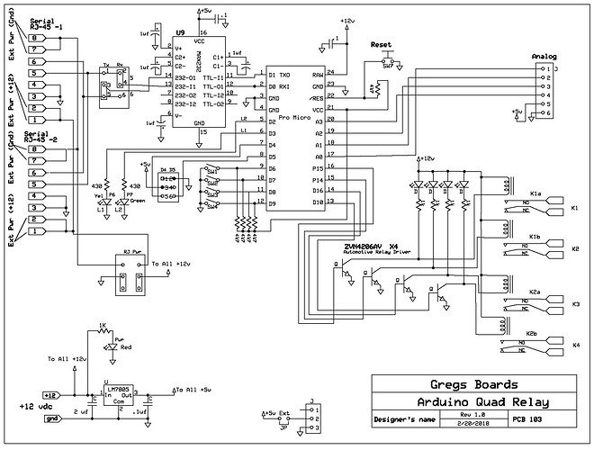

Ultimately, I want to run the board from 12vdc. My understanding is that I can feed 12v to the RAW pin and the onboard regulator will be happy and make me 5V at VCC. My current schematic is attached.

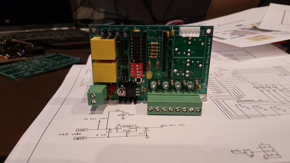

I made a PCB and tested everything I could before plugging in the ProMicro.
As soon as I plugged in the ProMicro, something snapped near the Regulator and the input diode. I didn't see exactly what. However, the ProMicro doesn't work any longer.
I only bought two of these (I have a couple more on order from Ebay) so I am not anxious to blow up another one.
I remember reading someplace that some of the less expensive manufacturers had been delivering ProMicro Leonardos with the diode backwards. It doesn't look like mine is backwards.
So am I missing something? Shouldn't I be able to apply 12V to Pin 12 of the ProMicro?
Here is a little description of my schematic..
12Vdc comes in. It heads for Adruino pin 24, my 7805 and to the coils of my 4 relays. My 5V regulator powers my Max232 RS232 receiver.
I have a little dip switch with pullups that I decided to power from the VCC on the Arduino but I know that wasn't necessary. I should have plenty of power. There are a couple of other LEDs that get directly driven from the Arduino.
The relay drivers are those little mos fets that are designed to driver relays with logic. Its like an npn Q but no resistor or clamping diode is necessary. I have used these many times. They should be fine.
It occurs to me that I can just jumper 5V from my own regulator and power the Adruino from VCC instead of applying 12V to RAW. I don't know why I didn't do that originally but that's not the current configuration.
Is it better for me to run the ProMicro from 5V connected to VCC?
Is the RAW pin really designed to take 12VDC?
I would appreciate any thoughts.

The specifications on the SparkFun Pro Micro say that you can apply up to 16V to RAW. Depending on where you got yours from, that may not be true for your version.
Yes, it's usually safer and better to use your own 5V regulator to supply all the 5V components on your board. Those little tiny regulators on the Pro Mini can't take a lot of current at 12V before they are toasted.
The "closed for 5V" jumper is related to the running voltage of the chip on the Pro Micro. It should not be necessary for you to touch that. It should be done at the factory.
Actual maximum voltage depends on the component (5V linear regulator) that was actually installed when the board was manufactured.
You would need to inspect that specific part number and find the manufacturer's associated datasheet and find the maximum input voltage rating. Parts may vary depending on production runs and parts availability.
The Pro Micro is a SparkFun Electronics design and details found here.....
You can supply 5V to the RAW pin and it should work just fine. VCC pin is intended for supplying regulated 5V to low current components like sensors.

USB bypasses the voltage regulator if it's set up as a 5 volt board (solder pads connected.) Raw goes through the VR either way. There is a voltage drop from the regulator. So putting 5 volts into RAW will result in the board operating at 4-ish volts. It will probably work just fine. Be aware that Microchip only claims that it will work properly down to 4.5 volts. Use your meter to check the voltage if you are concerned.
But to your original point, it wasn't low voltage that caused the "something snapped near the regulator" effect. My guess is that something was wired wrong, and that your chip saw 12 volts. The "snapped" part was probably one of the large capacitors near the GND and VCC pins, but if the 32u4 itself was exposed to 12 volts, the board is toast.
