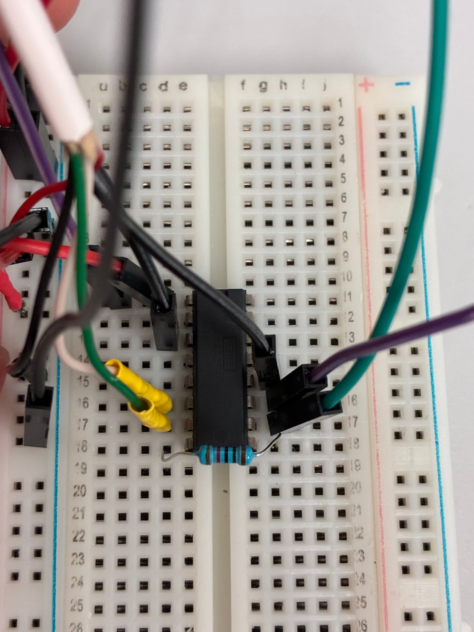

The Arduino Uno R3 is the mastermind behind the circuit. It is USB-connected to my computer for 5V of power. I then have the Arduino wired to the power rails on the breadboard to power the components in the circuit. The next component in this circuit is the INA125P to amplify the signal coming from the pressure sensor. Without the INA125P, the pressure sensor would have too small of a signal when powered at 5V. It would be too small for the ADC (ADS1115) to read with the INA125P. It helps to amplify the signal to a readable range. This increased reading varies based on the resistor you set at pins 8 & 9 (referenced from the pin diagram). I currently have a 10k ohms resistor, but I have also tried 1k. The INA125P also helps convert the input from differential (measures from pins 6 & 7) to a single-ended reading. Since I'm only taking one reading at a time, this is more practical. In the picture labeled "INA125P Wired", it shows how I've wired the INA125P (obviously :)). I will now explain what each wire goes to. At the top left of the amplifier (pin 1), I have it connected to the power rail, where it gets its power from the Arduino. Pin 3 is connected to the GND rail. Pin 6 is connected to the signal+ from the pressure sensor. This pin is the Vin+ while pin 7 is the Vin-, which is connected to the signal-. Pins 8 & 9 are connected with a resistor, which controls gain and amplification. Pin 10 (Vout) is connected to the ADS1115's A0 pin. This wire is the output of the amplifier (the final product that is then digitized to show a number on a display. Pin 11 is called Sense, and it's tied back to 5V (pin 1) as an output reference feedback loop. Pin 12 is the Voltage Reference COM, and it is connected to GND to ensure an accurate reading.

I can’t spend my time reading that lot !
Sorry to be harsh but … what is the photo ?
A proper circuit diagram would be good and links to the pressure transducer , what pressure are you measuring ?

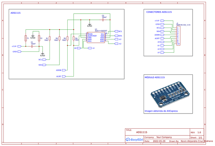

1. Ceck that the ADC alone is working by uploading te following sketch wen the input DC signal at A0-pin is varied from 0V to 5V. Report the result.

2. If Step-1 is working then connect the output of the pressure transducer diretly at he input of the ADC in differential mode.

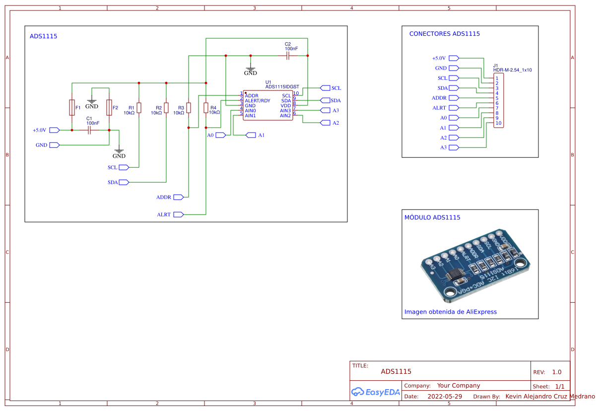

3. Follow Fig-1 below while connecting the ADC with UNOR3.
Figure-1:

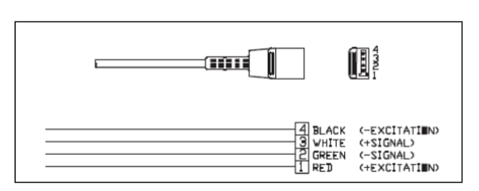

The photo is of the INA125P that I am using in my circuit. My main concern is whether I'm using the correct pins for this to work properly. My boss has told me that he wants me to use the PendoTECH Single-Use Pressure Sensor. This sensor has 4 prongs (wires), and they are listed in one of the pictures I attached initially.

Follow Fig-1 of #2 to connect your ADC with UNOR3.

To connect output of pressure sensor differentially with the ADC, follow this Table:
Signal Connect To
V_signal+ AIN0
V_signal− AIN1
GND (of signal source) GND (of ADS1115 & microcontroller)
Post a link to the sensor's datasheet.
