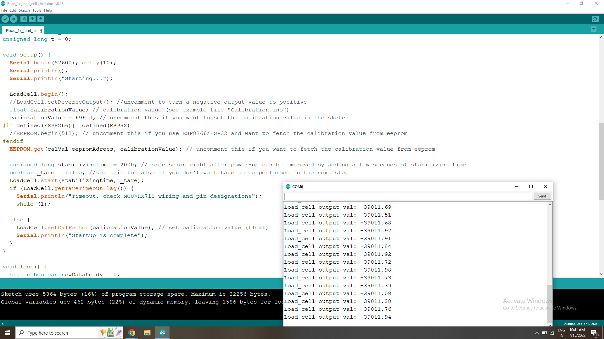

  boolean _tare = true; //set this to false if you don't want tare to be performed in the next step
Set this value to 'false' so it doesn't treat the current weight as 'zero'.
@johnwasser Its not working.
I am using this code (I only change anything in the void setup() part the other parts are left untouched as in the examples from the library):
  Serial.begin(57600); delay(10);
  Serial.println();
  Serial.println("Starting...");
  LoadCell.begin();
  //LoadCell.setReverseOutput(); //uncomment to turn a negative output value to positive
  float calibrationValue; // calibration value (see example file "Calibration.ino")
  calibrationValue = 696.0; // uncomment this if you want to set the calibration value in the sketch
#if defined(ESP8266)|| defined(ESP32)
  //EEPROM.begin(512); // uncomment this if you use ESP8266/ESP32 and want to fetch the calibration value from eeprom
#endif
  EEPROM.get(calVal_eepromAdress, calibrationValue); // uncomment this if you want to fetch the calibration value from eeprom
  unsigned long stabilizingtime = 2000; // preciscion right after power-up can be improved by adding a few seconds of stabilizing time
  boolean _tare = false; //set this to false if you don't want tare to be performed in the next step
  LoadCell.start(stabilizingtime, _tare);
  if (LoadCell.getTareTimeoutFlag()) {
    Serial.println("Timeout, check MCU>HX711 wiring and pin designations");
    while (1);
  else {
    LoadCell.setCalFactor(calibrationValue); // set calibration value (float)
    Serial.println("Startup is complete");
For this I am getting the following output (Note: The following output is obtained on startup when there is/there is no weight on the load cell):
What I have changed:
#endif
  EEPROM.get(calVal_eepromAdress, calibrationValue); // I have uncommented this line.
boolean _tare = false; //I have set this to false.
Questions:
  1. What is the use of the following line:
Is it useless for the code I am using above? Because I am using the calibration value from the eeprom.
Q2) Why is it showing -39000 as an output value?
And how to correct it?
Yes.
What calibration value are you writing to EEPROM and what calibration value are you reading back from EEPROM?
@johnwasser Using a calibration weight of 200g. I am writing a value of -204 and reading the same value.
