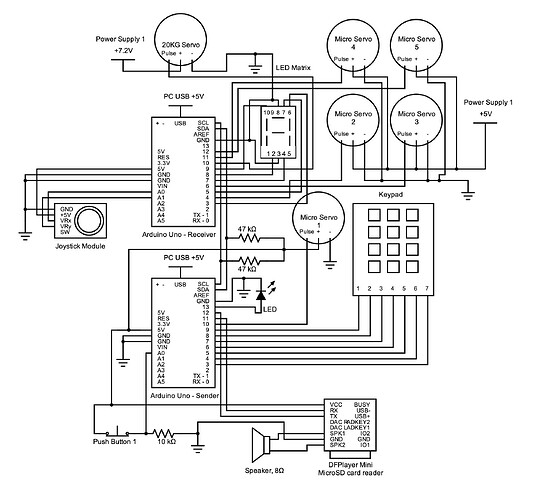

Thank you! Here is my current schematic for the whole system. The Arduinos work fine with their respective I/O when their grounds are not connected, but when they are, all I/Os, especially the servos, act up.

I suggest to not turn it on anymore. If you want to try the I2C bus between two Arduino boards, then remove all the servo motors and remove the extra power supplies.
The led and the 7-segment display need resistors.
It is not clear how the GND from the power supplies is connected.
Pin SDA and SCL are the same as pin A4 and A5. They are connected on the board. You have a push button connected to SCL on the Sender board. Pin 10 of the Receiver board seems to be connected to GND and to pin 3 of the display and to the Servo motor.
The video and the article on the dronebotworkshop website is informative, but there are mistakes. My main concern is how the I2C bus is used. It puts you on the wrong path. The I2C bus is not used to send text. Using it together with the String object in a interrupt routine is not good. Reading a single byte in a while-statement to keep the last byte is nonsense.
The pullup resistors on the I2C bus are missing (at least in the schematic).
A suitable value is 4K7 ohms.
GND must be common to both ONE's.

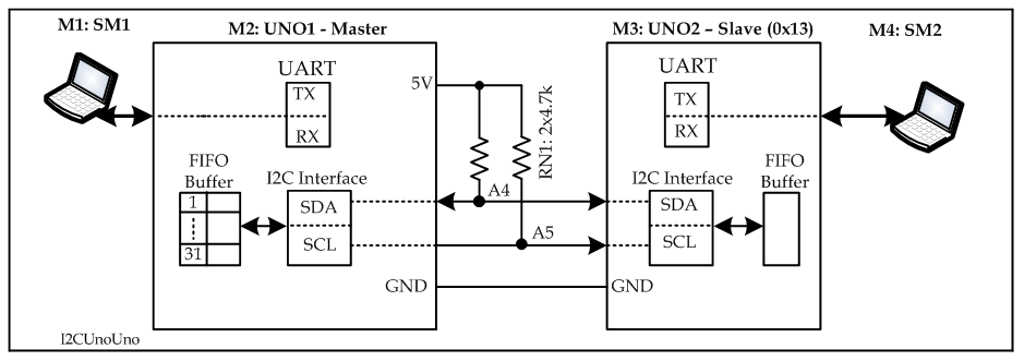

If you really want to understand the principles of exchanging data between two Arduino UNOs, then perform one task at a time like:
1. Connect two UNOs as per Fig-1.
Figure-1:
2. Create and upload sketches on both Master and Slave to check that the Master finds the Slave at I2CSlaveAddress at 0b0010011 (0x13).
3. add codes with the sketches of Step-2 tto exchnage data bytes 0x23 and 0x56 between Master and Slave.
4. Add Keypad with Master. Add codes withe seketches of Step-3 so that the data item 1234 entered from the Keypad will be shown om SM2 of Fig-1.
5. and so on......
6. The attached file may worth reading and practicing.
Ch-7I2CLec.pdf (334.4 KB)

Thank you! How is this new wiring diagram with the resistors added?
Okay, thank you! I updated the wiring diagram to add the resistors, does this look good?
No good! Check with Fig-1 of post #12 for pull-up resistors with I2C Bus.

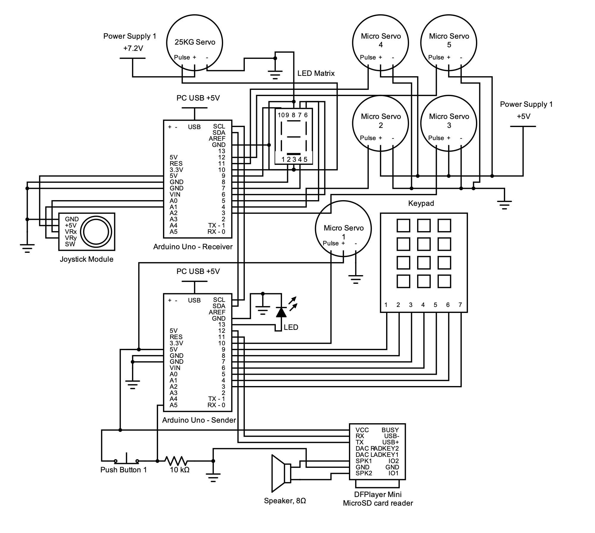

Ah, thank you. I think this revision is good now:
This solved the servo jittering, thank you so much! I suppose if you're using the SDA and SCL pins, you can't have anything wired or mapped to A4 & A5, correct?

That was an export error, sorry about that. I fixed the diagram with multiple suggestions made on this thread; only pins 3 & 8 of the LED matrix are supposed to be connected to ground:
