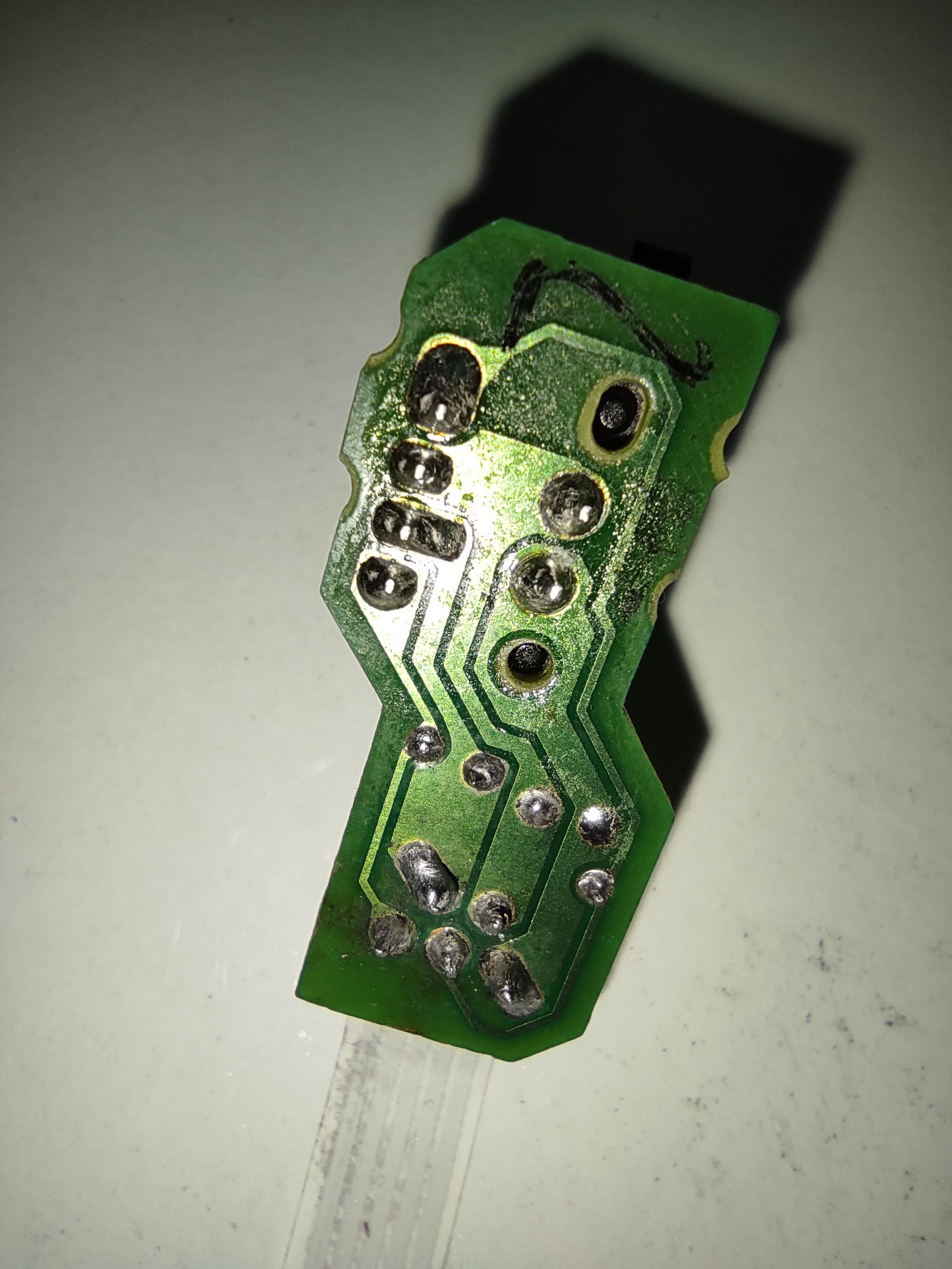

Can you help me with this printer encoder pinout?
I want use it with arduino and i connect pins to board but not work

I forget this photo
I connect those pins directly to leonardo board
But not worked out
Can the problem be resistance and capacitor? so that it is connected in an encoder that works :thinking:

What did the encoder do in the printer? How do you know it is an encoder and not just a paper sensor to tell the printer that paper is present in that location?
This device of yours is a strip encoder for canon G2800 G2000 G3800, just like this one.
I have several of these sensors removed from old printers that I got from friends.
The ones that are marked in red look like yours.
I already damaged some by connecting wrongly.
On one side they have an IR LED and on the other they have an IC that
detects the IR and amplifies the signal.
It is important not to connect the wrong IC, because connecting it wrong can damage it.
The PDF below shows more internal details of the sensor.

But i buy it from an store and he told me its a encoder with signal disk
And i search about it in google
And its look like the other one encoder and same pins on the main hardware but without resistor and capacitor :sweat_smile:

Yeah its look like them but I can't run it
Yeah i think connect them wrongly :smiling_face_with_tear:
But do you know IR LED work 5V or 3.3V?
The other one work with 1k ohm resistor on one side ( 5V ) and i think it's connected to IR LED pin
And a capacitor connected to both GND pins ( I don't know the capacitor value :sweat_smile:)
A LED does not work with a specific voltage, but with current.
With a 1K resistor as shown, there will be no problem with the LED,
because it must support currents in the order of 20 to 50 mA, and 5V with 1K allow currents of a maximum of 5 mA.
I think the voltage for this LED should be around 12V,
to allow a current of at least +- 12 mA.
As for the IC side, from the photo I can't determine which pins are signal and which are power.
I connected it to ardouino leonardo :sweat_smile:
First 3.3v and then 5 volt without resistor :smiling_face_with_tear:
I think mised up :joy::man_facepalming:
That gonna help?:sweat_smile:
