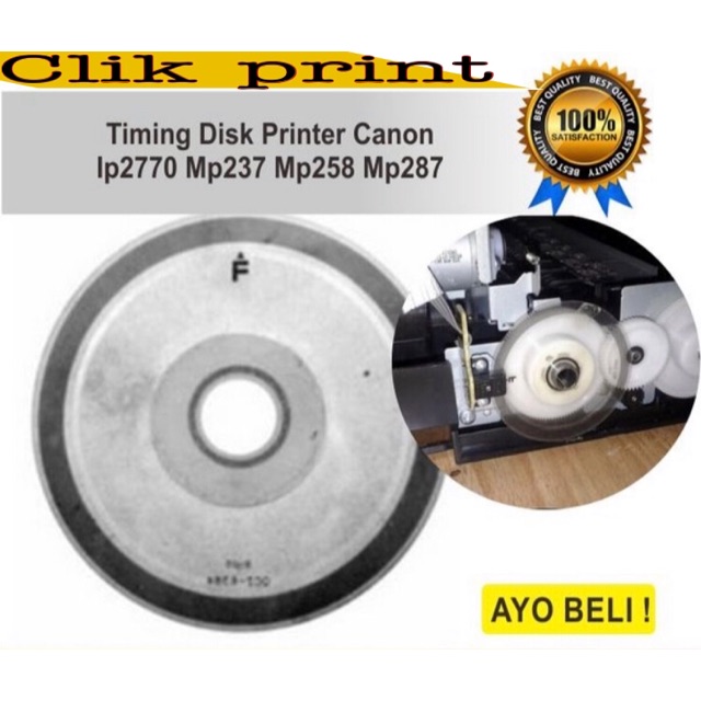

its something like this: https://down-id.img.susercontent.com/file/ee08dcfae82286792f7b409850e1c5ca in black part on brown site is place for timing disc - disc is moving part

Look at the link you posted. Do you see anywhere they call that an encoder?

"Look at the link you posted. Do you see anywhere they call that an encoder?" - i see incremental encoder - sensor + timing disc, look:

Hi, @marfuk123
Have you got the encoder disk that fits in the sensor?
If the sensor disk has fine marked gradations as the one pictured in post#6, then you will have problems using it unless you have the disk.
That disk is a printed disk, so possibly hundreds of pulses per revolution.
