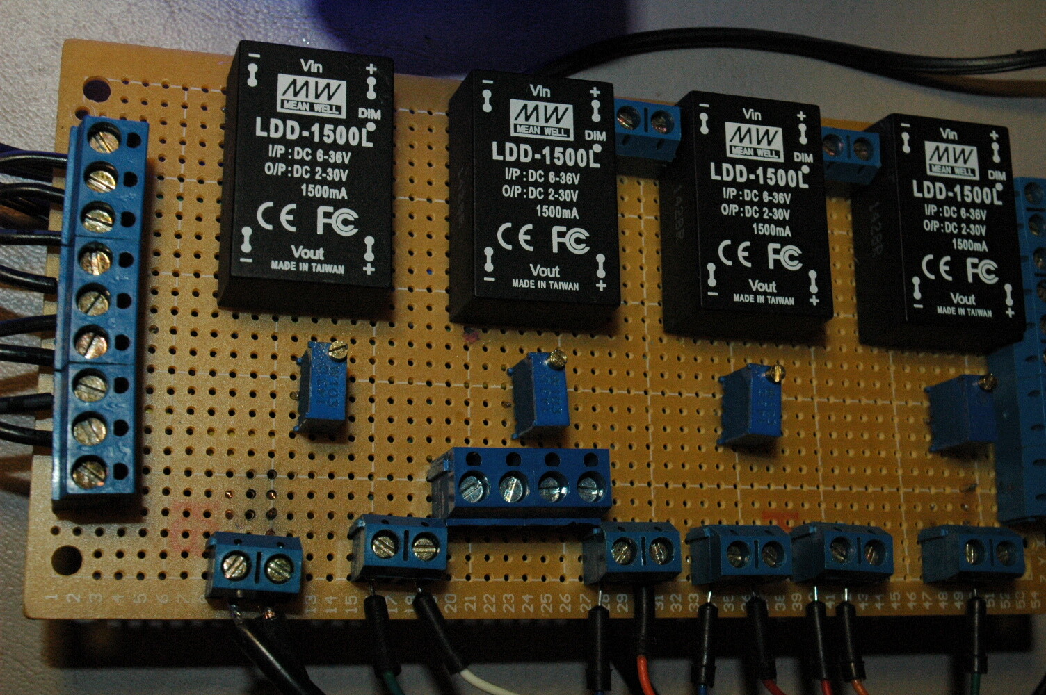

problem dimming LEDs with pots
When I plug everything in, the LEDs come on full power but the pots won't dim them. I double checked all connections and it's hooked up as shown.
I thought I used 10K pots, but I get 2.52K between the legs. At the endpoints between the legs and wiper I got 0, 2.52 and then the opposite endpoint, 2.52, 0. But between the endpoints I got numbers like 3.04, 3.11. Which adds up to more than double 2.52, but I still got 2.52 between the legs. Seems odd. It seems like I should still get a dimming effect, even if it were choppy. I used a fine adjustment 20-25 turn pots.
My plan is to get the dimming to work, then add a RTC, then work on a sunrise sunset effect. Is that a good way to build a sketch? This is lighting for a fish tank.

pots .pdf (499 KB)
Why are you doing digitalWrite() immediately after analogWrite()? Get rid of them.
Make sure you are measuring the pot out of the circuit.

It just occurred to me that the 2.51 number is because I have 4 10K pots in parallel. Does that sound right?
Can you post a picture of your pot?
Also a picture of your project so we can see how you have everything connected?
Yes if you are testing them in circuit, they are effectively all in parallel.
Use your DMM to measure the voltage going to the analog inputs as you turn the pots.
It should go from 0 to 5V.
Tom... :slight_smile:
Jiggy, I lost the digital write and now have dimming! Great call, thanks a ton! (:
Tom, Here's a pic of the project with lights dimmed way down and another as close as I could get to the pots.
Right now, the connections at the Arduino are skinny little breadboard wires inserted into a header. The connection seems kind of iffy to me. should I plan to solder directly to Arduino after I get an RTC and sunrise/sunset working?
