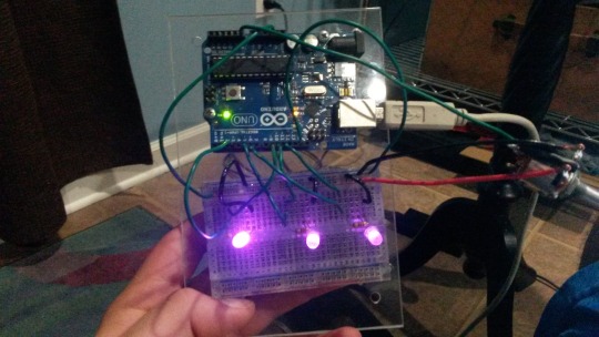

Problem with code? Dimming blinking LEDs with potentiometer.
I've been working on a project for about 4 months and I'm starting to wrap it up but I'm having some problems. I have 3 different sets of LEDs that I'm trying to get to flash as well as dim with a potentiometer. I've been successful in a sense but the blinking of the LEDs(rate and intensity) are largely uncontrollable. The code is a mesh of multiple codes with some of my own stuff thrown in. It all works individually but together it's just unsatisfactory. Any help would be appreciated.
Here is the code

Here is the setup

what is the code meant to do.
Im guessing that you might be trying to set the light level of 3 led pins by a pot then setting another 3 to change intensity really fast
im struggling because some of the names are used more than once.
anyway I stuck a few serial prints in the code to see what the arduino thinks its doing and it looks odd

serial print reported
 random -12
 ledstate 213
pin 9
 random 41
 ledstate 209
pin 10
 random 25
 ledstate 250
pin 11
 random 13
 ledstate 171
pin 14
 random 20
 ledstate 245
pin 8193
this is only 2 long....... 0, 1, 2
nt LEDPin[]= {9, 10, 11};
next "for" is 5 long
 for (int i=0; i<=4; i++)
shouldn't that be i<=2

I have had a look at your code. You have quite a few problems in there.
  1. a float in C++ is declared as 255f, not 255. Same with other floats.
  2. This part:
    analogWrite(LEDPin3,writeValue);            // set the pwm value of pin 3
    if (writeValue < 1) {
      writeValue = 0;
     analogWrite(LEDPin5,writeValue);    // set the pwm value of pin 5
      writeValue = 0;
    analogWrite(LEDPin6,writeValue);    // set the pwm value of pin 6
      writeValue = 0;
does not do whatever you think it does. It should possibly be this?
      writeValue = 0;
  1. In setup, you never did this:
    pinMode (LEDPin3, OUTPUT);
    pinMode (LEDPin5, OUTPUT);
    pinMode (LEDPin6, OUTPUT);
  2. This:
    analogWrite(LEDPin[i],randNumber);
    randNumber = random(-20, 45);          // generate new rand number add to current value
    LEDState[i] += randNumber;          // range can be tweaked to change intensity flickering
    if (LEDState[i] > 225) {         // clamp the limits of the pwm values so it remains within
      LEDState[i] = 225;            // a pleasing range as well as the pwm range
    if (LEDState[i] < 10) {
      LEDState[i] = 10;
should really be:
      LEDState[i] = 10;
Thank ya'll so much! My silly mistakes have been fixed and the problem has been resolved. im totally in control of the rate and intensity at which the LEDs blink and the range at which they dim has increased too.

    analogWrite (LEDPin[i], readValue);
    delay(100);                                   // the delay between changes
 Serial.print("You are writing a value of ");  //for debugging print your values
 Serial.println(writeValue1);
Thank you once again. this was a huge help
