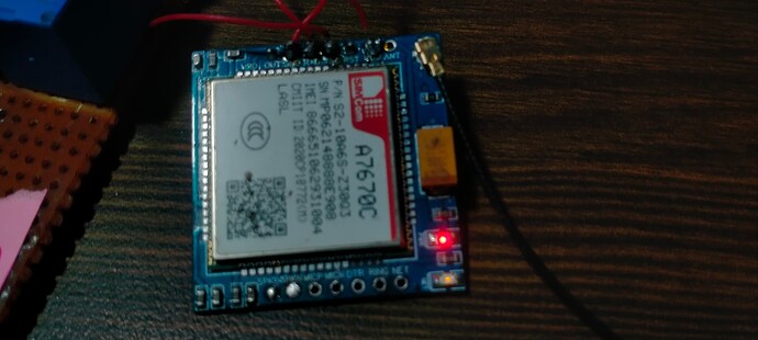

I am using A7670C GSM breakout board with an ESP32.
Connections
  • RX-TX
  • TX-RX
  • GND-GND
I am giving external power to the GSM module, 3.8 V according to the product description.
When I sent the AT command to GSM module, I don't get output on the serial monitor of the Arduino IDE.
The message is sent to a particular number successfully, but I don't receive the message from mobile.

how have you connected the A7670C to the ESP32?
how do you power the device?
note that the A149126_ADIY-SIM7670C-4G-Breakout-Board-V1.1_Datasheet.pdf states that Rx and TX are 1.8V logic??
Thank you for the reply...
RX2(GPIO 16) and TX2(GPIO 17) connected alternate to GSM's RX and TX
ESP32 GND and GSM GND and external power supply GND are common.
I have circuit that convert the AC power supply to 3.3 Volt DC supply.
I am getting 3.2 V at RX pin of A7670 and 1.8 V at TX pin of A7670.
think you require a 3.3V <> 1.8V level converter on the ESP32 serial to A7670C
ok I will try it

try with level converter otherwise you may have damaged the A7670C by inputting 3.3.V into the Rx
I saw some method to make bi-directional voltage level shifter but I got 5v to3.3 logic level shifter .can anyone help me to make 3.3v logic level shifter to 1.8 v
have a look at Sparkfun level converter - it states
This level converter also works with 2.8V and 1.8V devices
now my GSM module work properly . I want help to set the time of GSM by NTP server using AT commands
