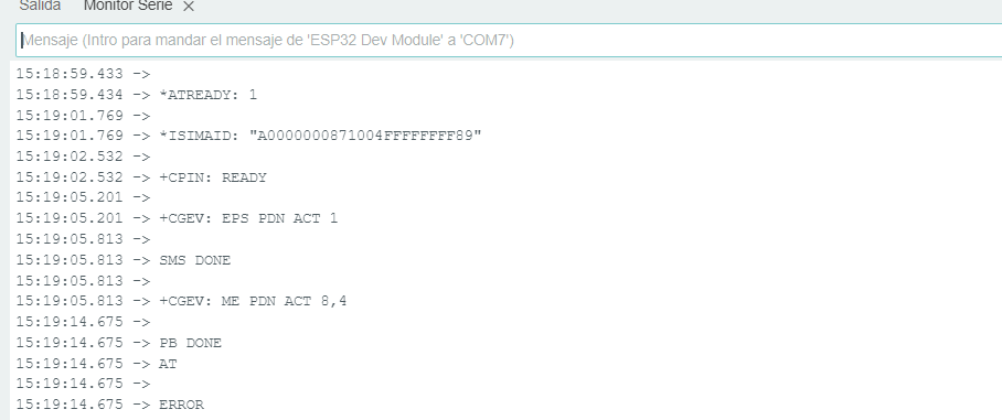

I'm having some issues trying to send AT commands from my ESP32 to an A7670SA module. I have set up my connection with the module, but when sending the AT commands, I do not receive responses, and sometimes, the module.
Here is my setup:
  • The A7670SA module is powered by a 3.7V 1800mAh battery.
  • My ESP32 is connected to my PC.
  • The connections are as follows: A7670SA's TX, RX, and GND are connected to ESP32's TX, RX, and GND respectively.

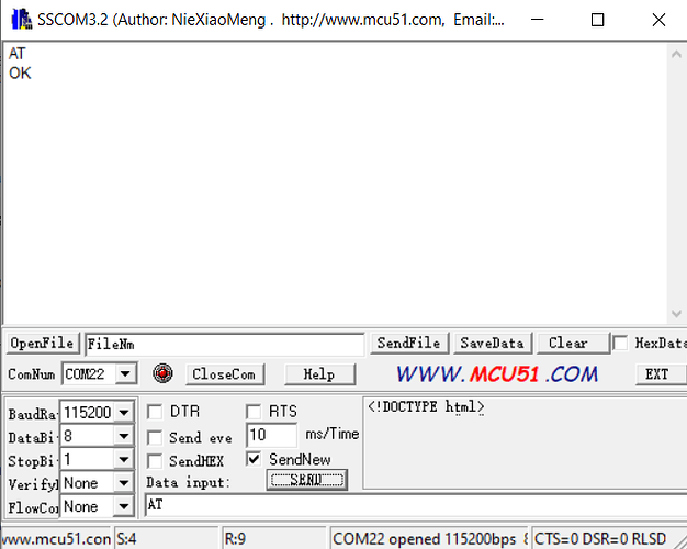

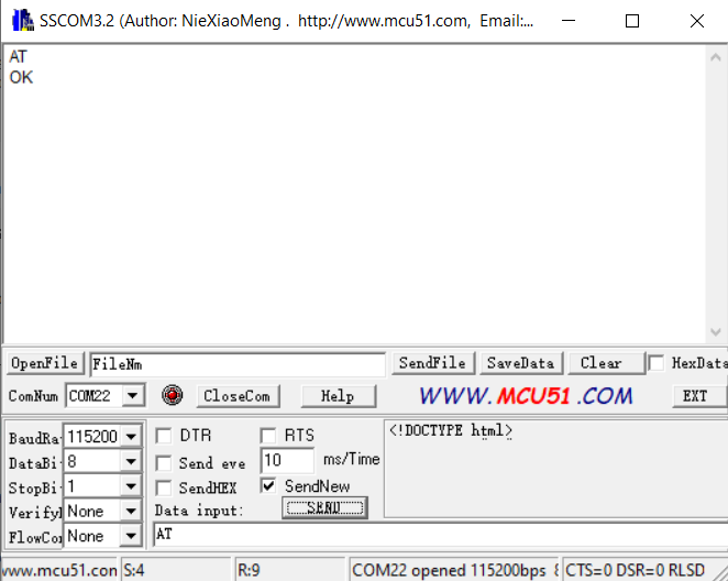

I have verified that the A7670SA module works correctly using SSCOM; it responds to commands without any issues. However, when trying to communicate with it through my ESP32, these issues arise.
I am attaching the code I am using:

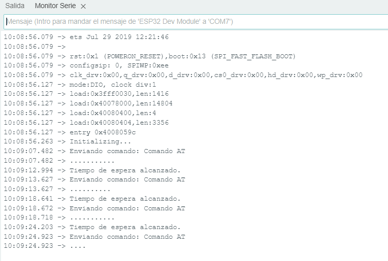

Thats i what see on the serial port

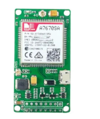

• This the A7670SA

I'm not familiar with ESP32s but as far as I know they have multiple UARTs. In which case I wonder why you use a band-aid like SoftwareSerial?
I decided to use a simpler code

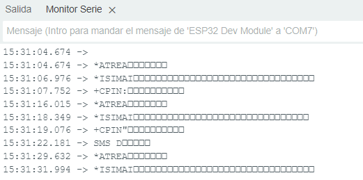

responds to AT commands but gives an error
I suspect it may be the module's power supply.
UPDATE:
• By powering the SIMCOM through vin and gnd with 7.7V 3A, and the esp32 connected to the PC, it causes the SIMCOM to reboot constantly.
• When powering the simcom and the esp32 connected to the PC via USB, it does not receive commands that I send in the code.
-- It is strange because according to the specifications it must be able to be powered from 3.4V to 4.2V.

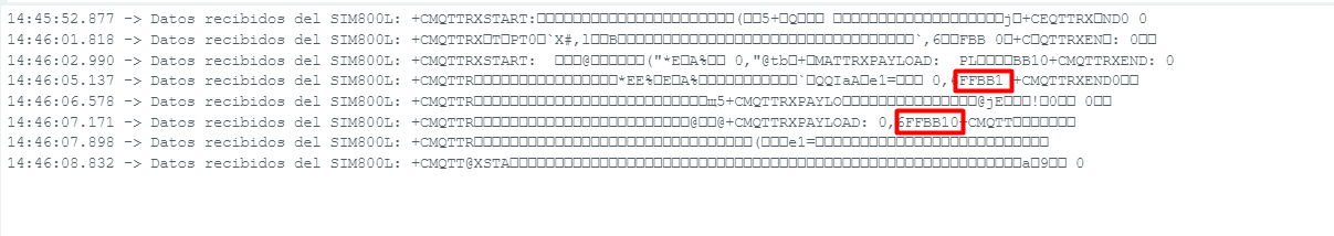

I can now bring information from my server, but when passing it to the ESP32 via serial it is lost or corrupted. What could I do to fix that part?
