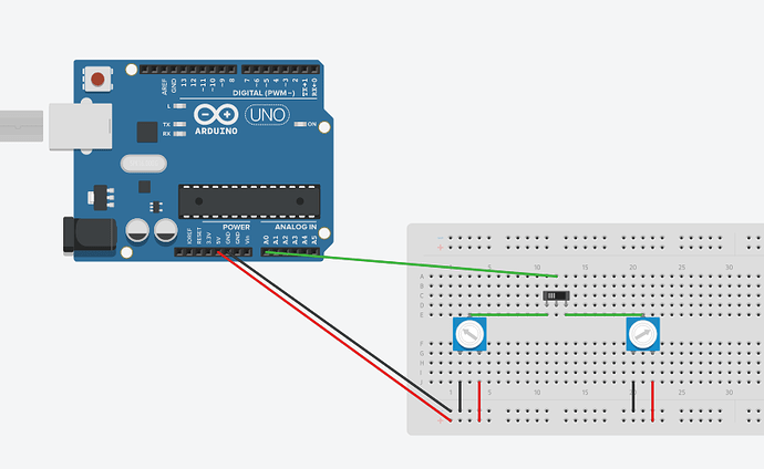

I think you should attach a schematic.
Not certain what is the best package to provide circuit drawings for this forum.
However a simple idea of the connections for the input side is shown in the image attached below (I know its a UNO and slider switch that is shown - but the principle with the Mega and toggle switch is the same) The input design is the same for 13 inputs. The outputs are servos connected to the PCA 9685 board which communicates via i2c with the Mega

Please include you power supplies, a hand drawn diagram is 10 times better than a fritzy picture when it comes to diagnosing circuits.
What are you using to power the servo's?
Can you post spec/data of the servo please?
Thanks... Tom... :slight_smile:
Is it the idea that the toggle switch can connect either one of two preset pots to an analogPin?
And is setting on the preset pot intended to define the angle the servo is to move to?
If so, I can't understand the role of pins 0-12 in your Original Post - or do you mean A0 to A12?

To answer your questions:
Is it the idea that the toggle switch can connect either one of two preset pots to an analogPin? YES
And is setting on the preset pot intended to define the angle the servo is to move to? YES
If so, I can't understand the role of pins 0-12 in your Original Post - or do you mean A0 to A12? My Typo - it should be A0 to A12
