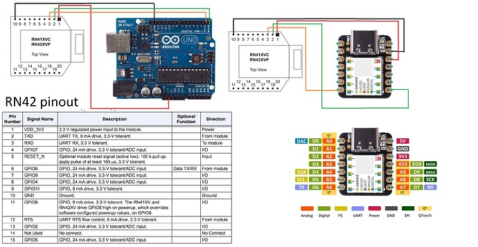

Please post schematics explaining things. You write "I connected" and that is not clear enough.
First of all thanks for your answer.
I will post the schematics as you requested, of course when I tried the software serial I connected the second and third pin of the RN42 to the seeeduino's 9 and 10 respectively.
That's not schematics. It's a tourist picture showing what the physical circuits look like. Helpers don't care where a connection is made on the physical circuit. What's interesting is what logic belongs to that pin.
Try again. Pen and paper, camera and posting.
I'll just post the Seeeduino connected to the RN42 since Arduino keeps working and doesn't represent a problem for me.
First picture: RN42 connected to Seeeduino's serial port made by pins 7 and 6: the red jumper goes from 3.3 V to VDD, the yellow jumper goes from Seeeduino's RX to RN42's TX, the blue jumper goes from Seeeduino's TX to RN42's RX and the grey one connects the two grounds.
Second picture: RN42 connected to Seeeduino's software serial port made by pins 10(TX) and 9(RX): the red jumper goes from 3.3 V to VDD, the yellow jumper goes from Seeeduino's 9 to RN42's TX, the blue jumper goes from Seeeduino's 10 to RN42's RX and the grey one connects the two grounds.
The third picture shows the connections to the module.
The module's led blinks when it is connected and then stays on when I enable the connection with CoolTerm.

There is nothing wrong with your diagram in post #3. It is clear, comprehensive, and very well-presented. One problem that it shows with utmost clarity that no amount of pen, paper and camera will improve upon is that your RN42 is connected to Uno 3.3v. Class2 Blueteeth are not famous for their frugality and Uno is not famous for its largesse at 3.3v. I'm not familiar with the RN42, but you may simply be short of power, so, if you haven't already done so, check what is common practice with these devices.
Further, you have probably also been led astray on the matter of serial. It is quite OK to use hardware serial as you clearly show, and you clearly know the correct procedure, but using software serial at 115200 is a certain recipe for disaster. Either go back to what you had before, or change the software serial to 9600 - and reconfigure RN42 accordingly.....
Other than assuming its 3.3v is kosher for Bluetooth, I can't comment on that Seeeeeed thing but I would suggest that your diagram in post #3 is one hell of a lot more usable than the photos above and, next time you get monstered by the circuit-diagram nazis, just tell them to piss off.
The RN42 is not popular with Arduino users. The 3.3v power requirement may explain this.
I have heard rumour that the available current on the 3.3v pin varies with different Uno manufacturers. None of them are that great.
Your serial monitor output in post #6 is probably indicative of how bad an idea software serial is! The fact the you got something - anything - does hint that you have not damaged Bluetooth but a 1k/2k voltage divider in the Arduino Tx line would be a wise move. The same might apply to the Seeeed.

Hi @alessandro_capresi
One issue is that the Seeeduino XIAO doesn't have SoftwareSerial, instead it's possible to configure the SAMD21's microcontroller's spare Serial Communication (SERCOM) modules, to provide additional hardware Serial ports.
By default the XIAO by should offer Serial1 on digital pins D0 and D1.
Furthermore, the XIAO's limited pin count notwithstanding, there's the potential to configure additional SERCOM modules detailed in Adafruit's excellent tutorial here:
It is a wise move for Arduino Uno because its uses 5V logic, but Seeeduino uses 3.3V
Well this was something I started to think myself yesterday, trying to obtain another serial port is probably the solution to the problem.
Thanks for your advices and for giving me confirmations for the use of software serial with Seeeduino.
If I wanted to use this option, how should I modify my code? By just changing Serial to Serial1? I tried to do this but it doesn't work.
By reading this procedure found in Seeed Studio XIAO SAMD21 by Nanase - Seeed Wiki
Serial1 should be used with the pins enabled for RX and TX by default i.e. 7 and 8 and now it works!
