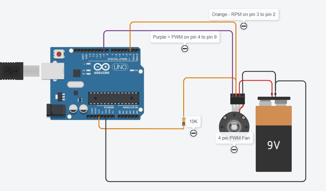

I'm trying to do a simple program to drive a standard PC 4 pin PWM fan. I have the PWM side working correctly care of a lot of posts on here, my next trick is to get the RPM of the fan.
What I'm not understanding is the micros(). I thought that I could set a start and end time variable with micros() and calculate the time from that, however when I try I get odd results.
When I was debugging this I finding that micros jumped forwards and backwards (see output below). Is this expected behaviour or am I missing something? Oscillicope output gives an ok output from the RPM pin.

Thanks for any help and guidance you can provide.

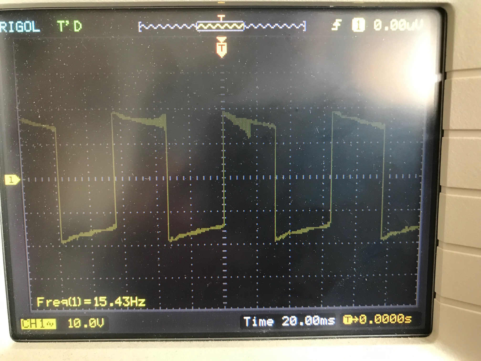

Hmm, I'm beginning to wonder if it's a hardware problem rather than a software one.
I've tried calculating the time between pulses a different way (without using an interrupt) and I'm getting random values all the time. I'm wondering if the trigger isn't enough to trigger the pin every time.
Here's the new code

And the output for a bit of the first cycle.
13:38:19.731 -> Cycle=0
13:38:24.741 -> RPM=0
13:38:24.741 -> Cycle=1
13:38:25.754 -> 6000
13:38:25.788 -> 45
13:38:25.788 -> 1
13:38:25.788 -> 14
13:38:25.821 -> 35
13:38:25.855 -> 19
13:38:25.855 -> 1
13:38:25.855 -> 13
13:38:25.923 -> 45
13:38:25.923 -> 1
13:38:25.923 -> 24
13:38:25.990 -> 68
13:38:26.057 -> 44
13:38:26.057 -> 1
13:38:26.057 -> 10
13:38:26.057 -> 1
13:38:26.057 -> 13
13:38:26.125 -> 49
13:38:26.125 -> 1
13:38:26.158 -> 19
13:38:26.192 -> 44
13:38:26.192 -> 1
13:38:26.192 -> 14
13:38:26.192 -> 1
13:38:26.226 -> 9
13:38:26.259 -> 55
13:38:26.293 -> 14
13:38:26.327 -> 63
13:38:26

Where are the pulses coming from. Maybe now is a good time to post a schematic and data sheet of the fan.
The pulses are coming from the hall effect sensor on the 4 pin fan. It's a standard PC 4 pin fan (Coolmaster DC1202512RFUN). Here's my circuit (not great at tinkercad for circuits I'm afraid).

Here's the output I'm getting on my scope for one of the cycles.

Is the power supply really.a 9V smoke alarm battery? If not, what are the specs of the supply (Volts, Amps)? Why is the pull-up on pin 2 to 3.3V, not 5V? Why not use the internal pullup on pin 2?
I am having a hard time finding info on the fan. Can you post a link to a data sheet or manual?
What is the amplitude of the pulses on the scope photo?
Yes, (for now) the supply is a 9V smoke alarm battery 6LR61. I will use a 12V supply when I get this all working.
The pull up is on the 3.3v supply because that's what the diagram used (one link is here but there are others that all point to the same). I've also stuck the resistor in there as that's what the other diagrams do (although resistance values vary).
I don't have a datasheet, but have been assuming that the fans follow the standard here
I've just put the pin in 5v rather than 3.3v and the output on my current non-interrupt code is looking a lot better (69, 36, 27 and 21 +-1 consistently), so that's a good step forward thank you. I'll try working with the interrupt version now.
