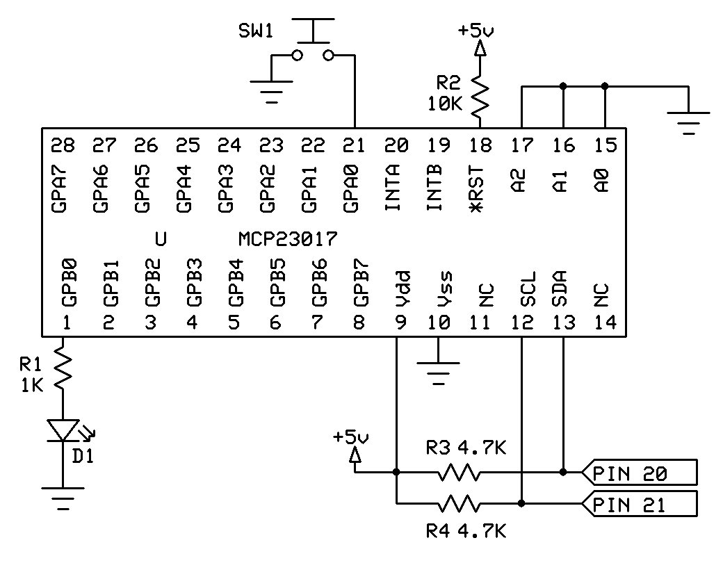

Before explaining my silence these past few hours, I would like to announce that by using the suggestions from everyone, the MCP23017 chip is WORKING.
Here is my code (I combined it with a pushbutton-activated mode switching sketch to turn on or off an LED. It has the same wiring as the code @groundFungus supplied):

One thing that I want to mention is that my schematic shows no pullup resistors on the I2C pins. That is because the Mega board has 10K pullup resistors on the I2C bus. Other boards may not have those pullups (internal pullups are usually not strong enough). If used with an Uno or Nano, for instance, the chip will need to have external pullups installed. 4.7K is the oft recommended value.
Oh, ok. Thank you! I did not know that.
That would explain how some diagrams show pull-up resistors and some don't.

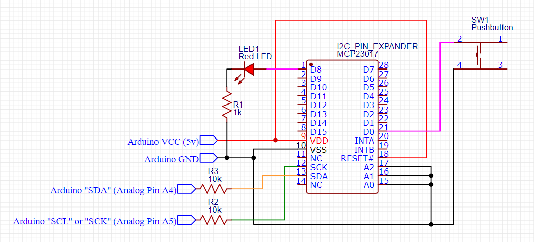

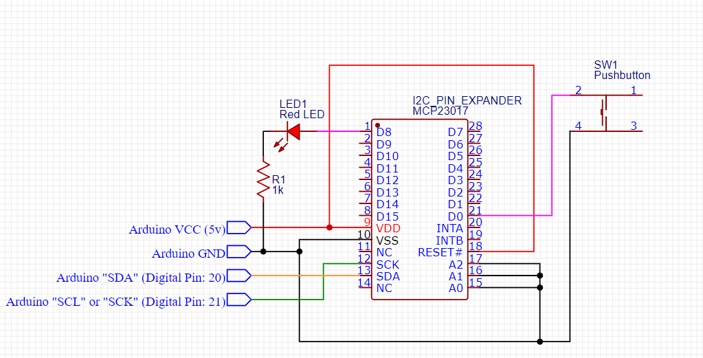

  1. Always run an I2C Scanner before you test a new wiring setup to check that your board is able to communicate on the I2C bus well. If successful, move on to the next step. If not, follow this wiring diagram for the Arduino Mega:
Below is the wiring diagram for almost any other board:

Sorry, but your second schematic is not quite right. The pullup resistors on SDA and SCL go from those pins to Vcc, not in series and the recommended value is 4.7K.
