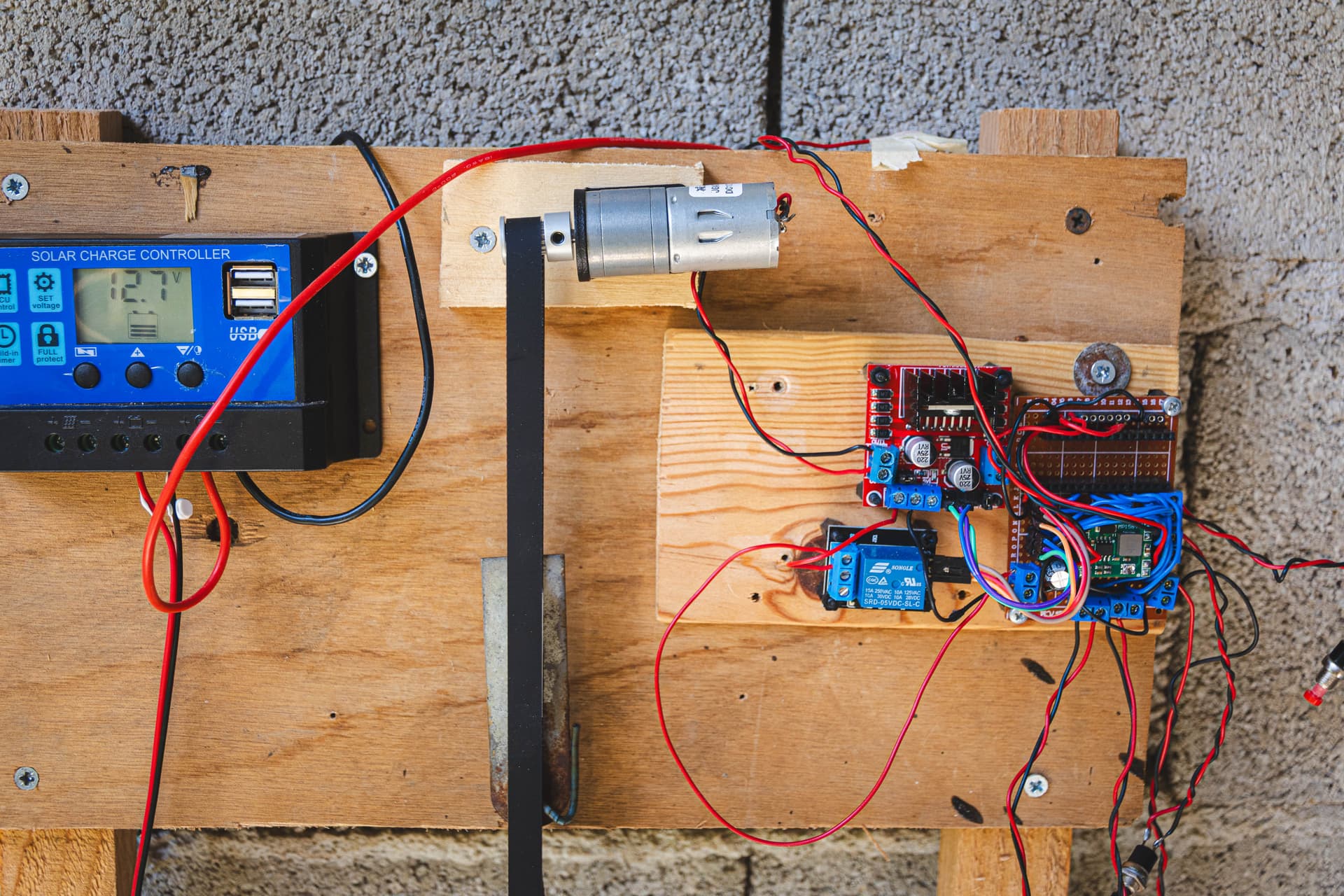

I'm working on yet another automated chicken door.

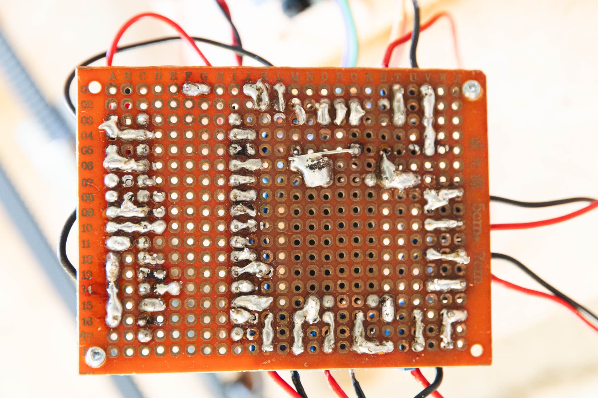

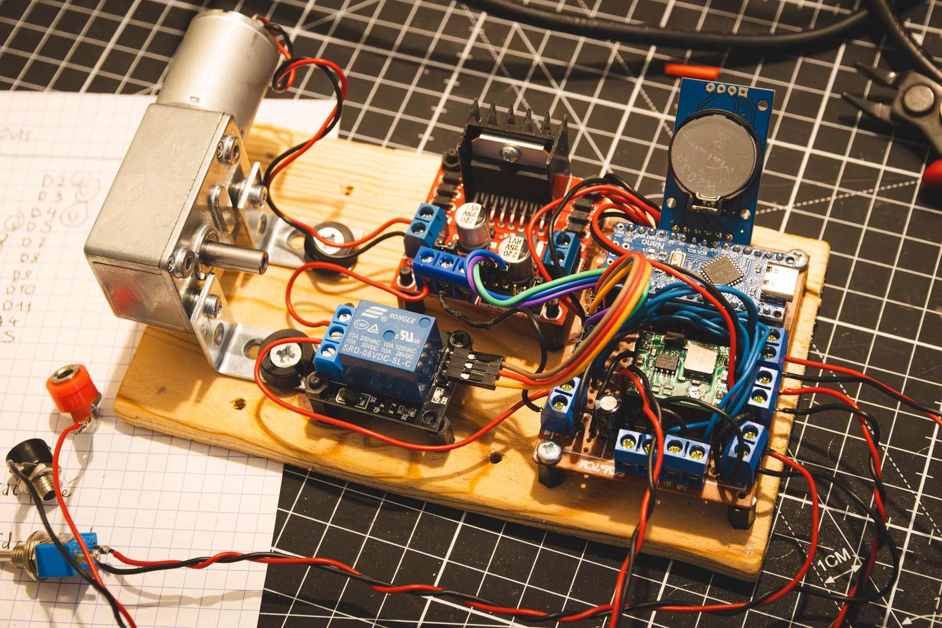

I was happy of the first breadboard test phase, and soldered it into a protoboard for testing.
The project is powered by a small solar panel + controller.

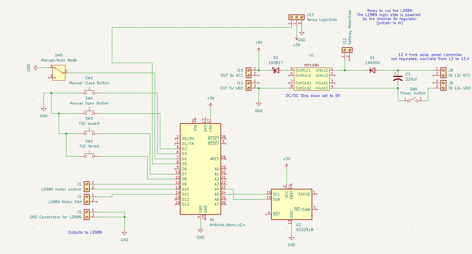

It use a RTC3231 to setup the opening and closing time, a L298N for the motor, and a relay to switch off the L298N when not in use. There is a switch for auto/manual mode, with button to control the door in manual mode.
I installed the circuit in test mode, and it works as it should, for a few hours, or even a few days, but then it start to behave erratically:

Another suspicious thing, at some point i disconnected the 12v power and plugged the USB to the arduino, the arduino USB port smoked directly. But it is still working. (i changed it still in case, to be sure it is not the problem).
Note: This was before adding the Schottky diode after the stepdown +5 DC output, i did not retry it, didnt want to fry another arduino

  • Replace the relay by Mosfet/transistor system to cut more properly the L298N 12v and 5v, this time not using its internal voltage regulator for its logic part.
I would be very interested to have troubleshooting ideas from more experienced people around here to put me back on track !
Here is a KiCad schematic

You should investigate this first.
I wonder if your board is correctly protected.
Maybe you want to post some good photos of your circuits.

I added a diode at the output of the +5V from the stepdown module now, I still didnt test if arduino will still fried if usb powered while in the circuit.
Maybe a diode between the motor and the circuit to avoid current getting backward could be a good idea ?
Some decoupling 100nF caps for some of the UC could maybe help to stabilise a bit as well ?
I was thinking to add a 220uF cap just before the L298N +12V input too.
As it is a protoboard it will be hard to guess from pictures, but here are some:
The soldering is "a bit" sloppy, but if it was a short i suspect it will not work for hours/days before problems happening.
The idea was to test it on the protoboard and etch a little PCB afterward to have something cleaner.

Hardware, things I would suspect:
L298 overheating and shutting down
MP1584-adjustable: Those tiny little pots can be very unreliable.

If it's stable, well regulated and free of voltage transients.

But you need to be sure you don't give it more than 13.5V.

I personally don't like those adjustable buck regulators with the tiny pots.

If you are going to use a linear regulator, then you might as well connect the 12V to the Nano Vin and use it's regulator but again heat may be an issue.

Yes +12v for the VIN input is maybe a bit much.
Would you have a recommandation of a better way to get a proper 5V line from my +12v input while keeping the power usage on the low side?
Reducing it to around ~7-8v and then use the VIN could be an option as well maybe.
