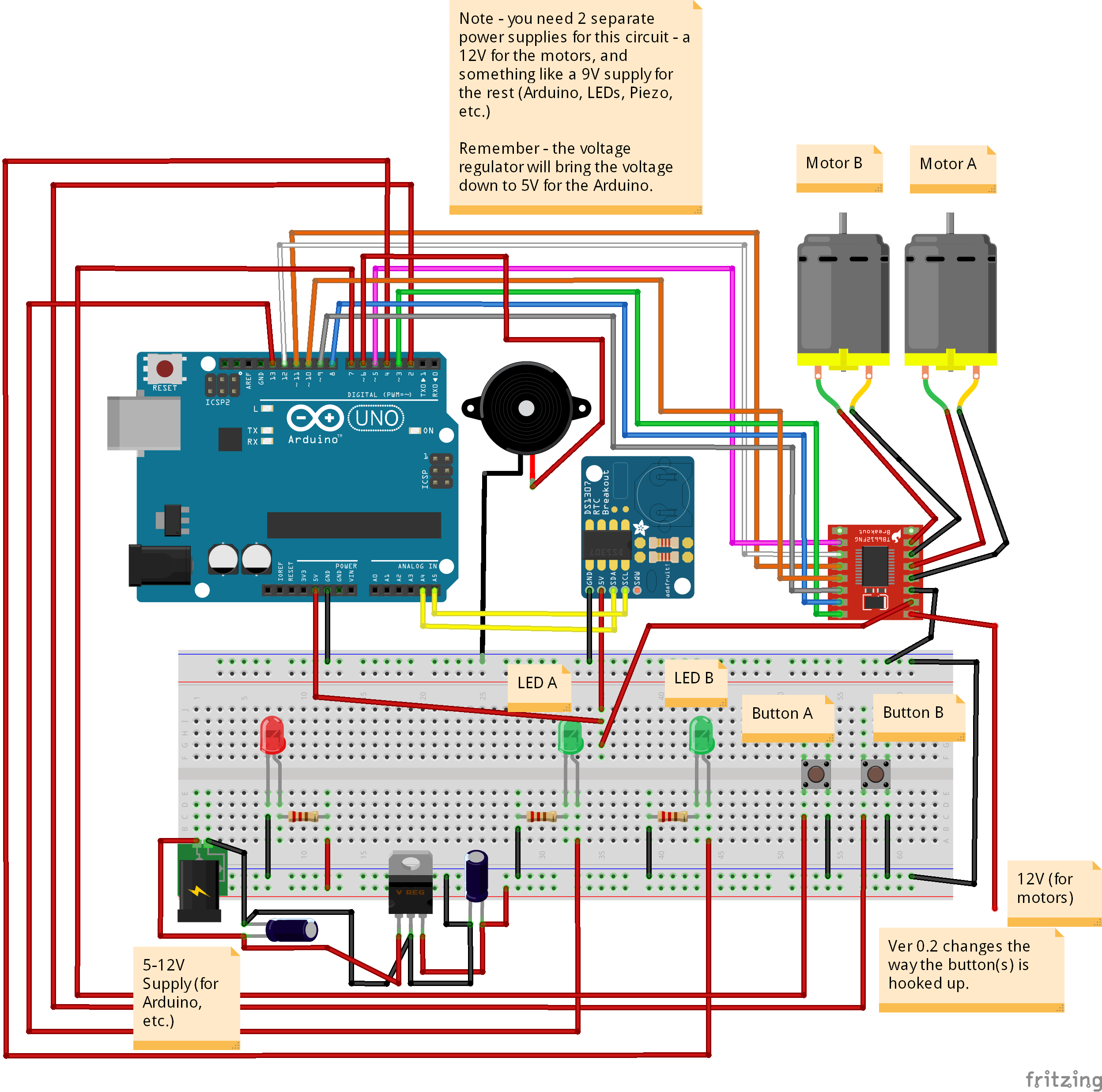

I've got a circuit on a breadboard trying to drive 2 motors (independently of each other) with my Arduino and Sparkfun TB6612FNG motor driver.
Here's the circuit:

Again, it's worked great for 1 motor, but now that I've hooked up a second motor, and try to run it after the 1st motor (Motor A) runs, this is where I'm having the problem. What's happening is that the first motor never turns off it seems...it keeps going while the 2nd motor runs for it's few seconds...then they both turn off at the same time.
You'll see it in my Arduino file, but the updated 'pseudo' code would be this:

I keep looking at my code and don't see anything wrong, but I've obviously done something wrong.
I'm hoping someone will see something dumb in my code that I did wrong and point it out to me.
Here's a video of it in action:
It's kind of hard to see, but the 2nd motor does start up (you can hear it) just fine, but you'll also notice that the motor on the right (Motor A) never seems to stop (until the the 2nd motor stops anyway).

I'm glad I had your description. I missed the alarm-setting function the first time through. (None of the other code seems to use button B or motor B so it took me a while to find where motor B was started.
OK, first problem: you are using "A" and "B" to refer to the motors in your comments but then it's 1 and 0 in the actual code. #define a constant to do this translation, so you always refer to it as A and B everywhere. Or change the whole program and call it motor 1 and motor 0 everywhere. (This may also reduce mixups with the buttons labelled A and B.)
While you're running the motor for 5 seconds, do you expect any other alarms to arrive during that time and require some action BEFORE 5 seconds has expired? If there is an alarm, does it know if the motor is running and should it be switched off? Just use the regular Arduino delay() function instead of Alarm.delay(). Then let the alarms be answered after the critical motor-operating delay.
Now I think I might ave found the real reason. After starting one motor or the other, how does it stop? You call stopMotor() but that takes no parameters - it doesn't know which one to stop. That's OK, maybe it's meant to stop both. But it only writes LOW to one output pin. OK, maybe that's the standby pin for both outputs of the TB6612 chip but there's nowhere that gets set high anywhere other than the setup() function.

You did find the real reason! Remember how I said that I mostly have taken other people's code and mashed them together? Well I got most of the motor-driving code from:
http://bildr.org/2012/04/tb6612fng-arduino/
It seemed like they were stopping the motor with their 'stop()' function (which it was when there was only 1 motor involved). Between you bringing up the whole question about STBY not specifying a motor, and only writing LOW to one pin, I remembered that they said that you have to turn both pins LOW or HIGH to turn the motor off. So as a quick test, I inserted:
  digitalWrite(AIN1, LOW);
  digitalWrite(AIN2, LOW);
like so:
 playBreakfastDinnerTones();
  digitalWrite(LEDA, HIGH);  // turn status LEDA on
  moveMotorHighLevel(secondsToTurnMotorA, 1); // Run motor A
  digitalWrite(LEDA, LOW); // turn status LEDA off
   digitalWrite(LEDB, HIGH);  // turn status LEDB on
   moveMotorHighLevel(secondsToTurnMotorB, 0); // Run motor B
   digitalWrite(LEDB, LOW); // turn status LEDB off
and that properly turned off the first motor before starting the 2nd one!!
