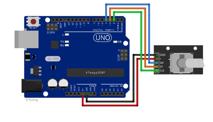

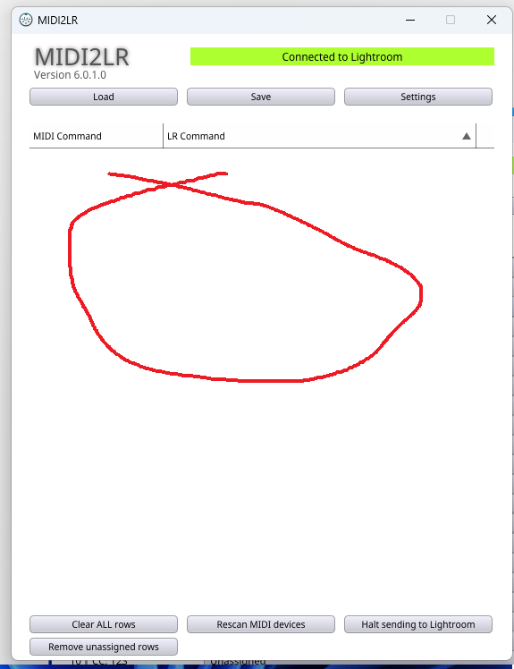

Problem with errors in the code
Hi, have bought a number of rotary encoders and pro micro cards. Trying to get this project's (GitHub - phcreery/Encoder2MIDI: Use arduino with Rotary Encoders to control Lightroom/MIDI software) code to work but I'm running into problems when checking the code. Is there anyone who can help me? Thanks!

The rotary encoders do not work and no midi device in device manager.
No Midi message in serial monitor. Will try that PieterP, thanks!
I understand, I am grateful for your help and patience, I understand that it is not easy. I'm trying to get the rotary encoders to respond. But nothing happens, no indication of signals coming through. Nor in serial monitor. I have asked two programmers at work for help, but they are as confused as I am about the problem.
Okay, the idea of ​​this midi controller project is to control Adobe Lightroom via the Midi2LR plugin.
Have previously used this with ready-made midi controllers but wanted to build my own this time.
The idea is when you turn the encoders you should get a value between 0-127. That's the whole idea behind the project.
But it seems that windows 11 fails to identify the arduino as a midi controller, my amateur guess is that there is something wrong with the code. Maybe better to start from scratch and try to write something simple myself that works and then advance from there. I may have embarked on a too difficult project for my level of knowledge.
You would get a result like this when you turning each encoder but I get literally nothing.

To test the encoders, use a simple program that does nothing but interface with the encoders, and prints current values on the serial monitor. Most, if not all of the encoder libraries have such an example.
That approach is the first and basic step to take with any sensor you connect to the Arduino.
Alternatively, but not as straightforward, you can add Serial.print() statements at the point where the encoders are read out, and see whether the printed values make sense.
I tried each KY-040 Encoder with this simple code and wiring and they all work as they should.
#define CLK_PIN 2
#define DT_PIN 3
#define SW_PIN 4
int position = 0;
int last_position = 0;
int n = 0;
bool taster = LOW;
bool last_taster = LOW;
pinMode(CLK_PIN, INPUT_PULLUP);
pinMode(DT_PIN, INPUT_PULLUP);
pinMode(SW_PIN, INPUT_PULLUP);
n = digitalRead(CLK_PIN);
taster = !digitalRead(SW_PIN);
if(taster != last_taster) {
Serial.print(position);
Serial.print("|");
Serial.println(taster);
delay(10);
last_taster = taster;
// one tab
if((last_position == 0) && (n == HIGH)) {
if(digitalRead(DT_PIN) == LOW) {
position++;
else {
position--;
Serial.print("|");
last_position = n;
Great! The next step is to put Serial.print() statements in key places in your MIDI code, to see if variables are what you expect them to be.
