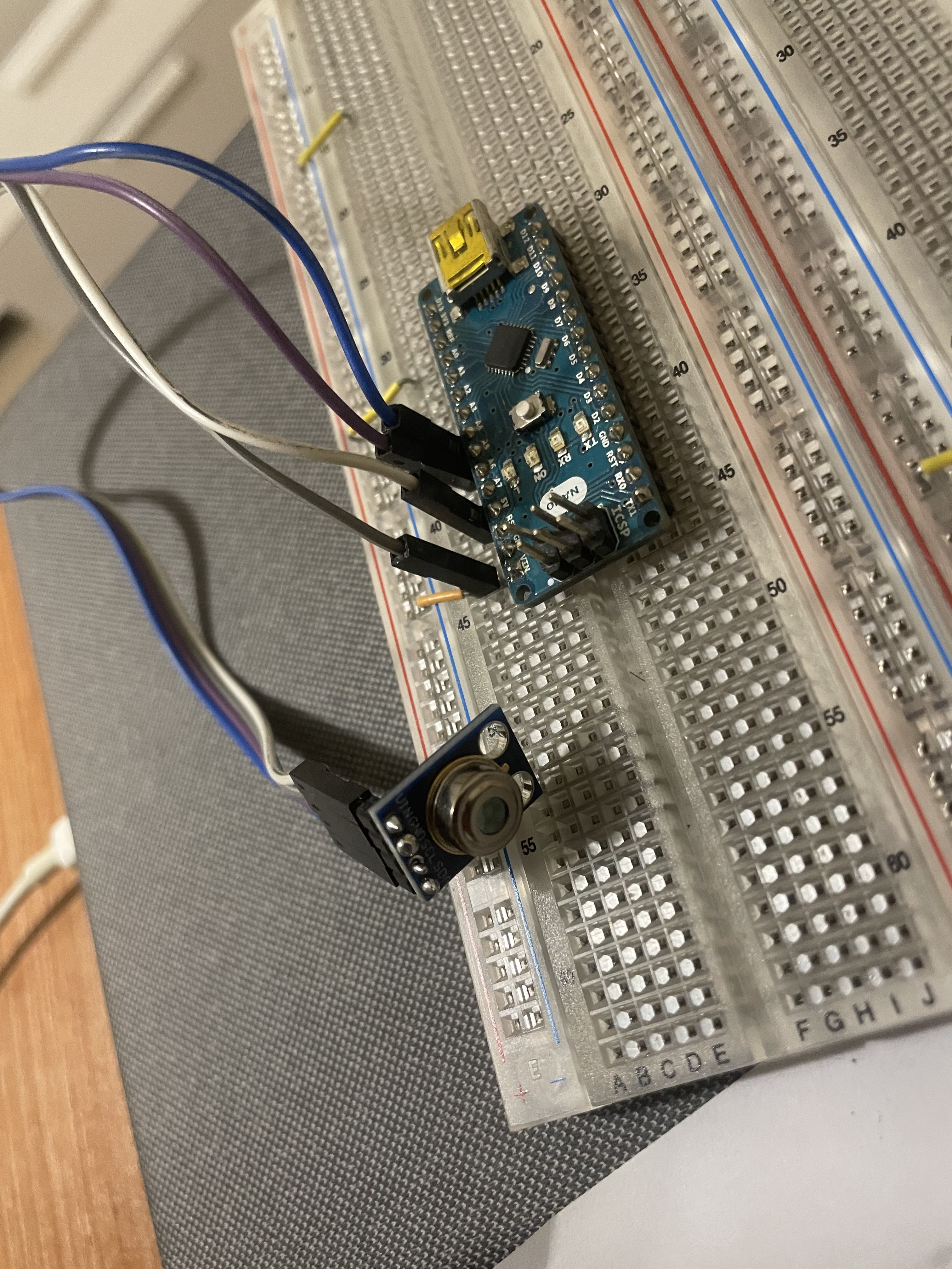

Hi, I have a problem with gy906 IR sensor.
It’s the 3.3V model but my arduino nano didn’t see it at all.
I tried everythings, changed ports and also.
Anyone can help me?

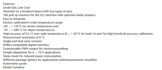

Can you post a link to data/specs/where you purchased the sensor.
Most modules are 5V with a 3V3 regulator.
I bought this:
I connected this to 3V pin, GND, A5 and A4
Classic board, I used it before and also if I use a 16X2 LCD i2C it works

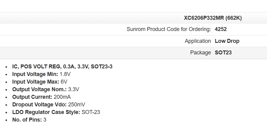

Can you tell us what is written on the circled component?
I got to get some of these, 1TB and 1GHz speed.
Your module may have a 5 to 3v3 regulator.

The code is:662k

I think thats all ok with wires
It is difficult/impossible to see which pins the wires are connected to on both ends
Vin-->5V
GND-->GND
SCL-->A5
SDA-->A4

662K ia a low dropout 3V3 regulator.
So the Vin of 5V is fine.

I am not sure about the 3,3V anf 5V business.
If you have 3,3V Sensors, this might be a problem, if the Arduino tries to communicate with 5V with them, when they are not 5V tolerant (might destroy them).
Another thing: Do you have applied pull up resistors? Can be, that this is in some combinations running without, but normally with i2c pull ups are needed:
But careful with the 5V! I am not sure, but I guess, that the sensors might be killed by that.
