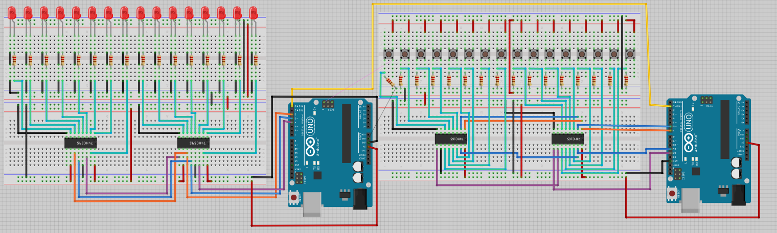

Hi everyone,
Its my first time here on the forum and i have a programming issue, i did my search (because i hate asking people for help) But i couldnt find notthing on the internet that could solve my problem:
Juat to make thing clear i have no trouble using my 74h595 and my 74HC165 work.
I am working on a big projet but i decided to simplify the circuits juste to make sure everything works fine.
I have to use the input data of the 74HC165 and send it to an other Arduino by serial. When he receive the data it must be able to light the good LED. Also if more than one swiches are pressed , then the equivalents LED must be turned on (ok no there is nothing wrong with turning LED on =P ).
Here is the code of the first arduino (the one with the Switches) :

On the serial it looks like this:
1000000000000000
0000101010000011
0000000000000001
This is not binary (well i guess) , each 1 represents a switch that is pressed. The numbers are in order of the switches and there is 16 numbers.
And here is the code of the second arduino (Yes the is just 8 LED for this one and it is not meant to receive data in the format of 10001010101010).
I want him to take the data from the serial and to convert it into a simple number in order to light the good LED..

Can someone please help me, i search like crazy to find a solution but i couldnt find one....did i miss something? I'm not an expert in Arduino! Thanks!! :slight_smile:
PS:The wiring on the breabords view may not represent the values on the code, but its just to illustrate my setup
Hi, do both the arduino use the same power supply, if not your only connection between them is the tx line, you need a current return.
So connect the gnd of the ardinos together please.
